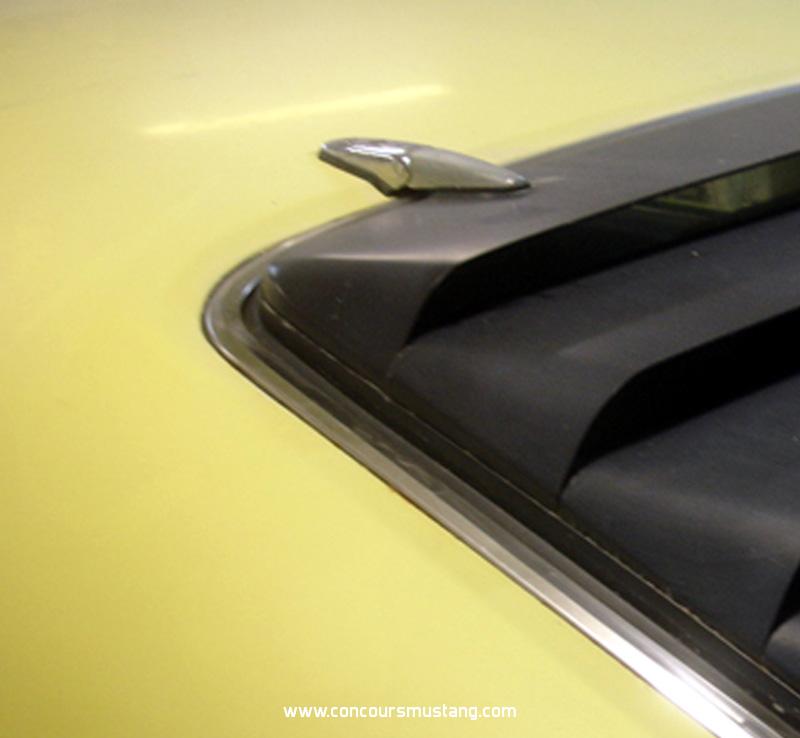

I would be very appreciative if someone would be willing to snap a few photos of their 69 or 70 louvers, as they sit on the car. Specifically, I am trying to see the relative distance between the trailing edge of the hinge and the edge of the roof/glass.
I had to replace my roof and I have the rear glass reinstalled with the louvers and hinges sitting on the glass. I *think*, but am not certain, there should be approx 1/8" to 3/16" gap between the edge of the roof and the hinge. I'm looking for photos and/or measurements from other cars to confirm this.
In case it helps someone in the future, the louver latches are affixed to the panel behind the window, 1/2" to 9/16" below the glass/panel edge. You can almost get that right without measuring due to the fact that the gasket makes a pretty nice template. :-)
On a related subject:     Are the reproduction louver hinge gaskets (between roof and hinges) thicker than the OEM? They seem too thick, which causes the hinge to hold the louvers off of the glass near the top.

Only shot I could come up with 70 Dearborn example

My 69.  Brian

Brian are those original hinges and latches in the pictures or repops? I have been thinking of replacing my originals as they are not pristine and wondered how good the repops are before I go spending money on them.

In these pictures the hinges and lower latche's are OE.  I have since replaced the uppers.  Very negligible differences.  Mostly a difference in the hinge pin appearance. On my original uppers the chrome faded away on one section-2nd pic. I think re-chroming would not worth the effort.  Brian

Brian, in your top photo, if you pressed down on the section of the hinge (with the screws removed) which attaches to the roof, do you notice the louvers lifting off the glass about 1/16" or a little more?

Thanks for checking Brian.    I am puzzled as to why my louvers don't touch the glass at the top of the glass (adjacent to roof) on the driver's side. Passenger side seems fine. I've tried the OEM hinges as well as the NPD hinges and find the same issue:  With the hinge attached to the louvers, I can lay the louvers and hinges onto the glass and set them onto the roof gaskets. If I then press down on the hinge as if I was tightening the screws into the roof, the louvers lift off of the glass about 1/16" or perhaps a little more. I can't figure out if the problem lies with the roof, the glass, the louvers being bent? Everything looks straight and normal except for the air-gap I've described.
