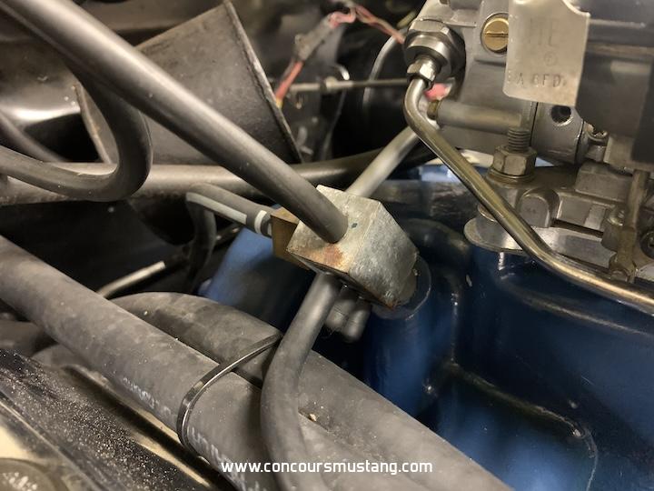

  • you can see the current front intake manifold fitting on the attached pictures. I do not think that it is the original one. Do you confirm ? If yes, what is the correct PN of this intake manifold fitting, which is, today, only connected to the brake booster
  • as you can see on the attached pictures, the PCV valve is directly connected to Power Brake port of the carb. Is-it correct ?

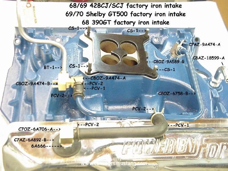

Isn?t it:
Left to right:  428CJ  -  390GT  -  PI
The nipple that comes off flatter is for the 428CJ because the intake runners are so tall that the nipple accesses above the valve cover at a flatter angle.  390GT and PI intakes are more shallow, so the nipple has to extend at a sharper angle.  I didn?t know there were 3; I thought it was 2, PCV tubes that is,  the FE and the 428CJ.

Great diagrams. So according to the drawing it shows the Canadian air cleaner with the valve cover breather tube & distributor vacuum off the carburetor.
On the last post it shows the 3 different PCV tubes, but the middle one for the 390 does not show the vacuum fitting that goes into the intake. I am looking too confirm what both fittings looks like as I have seen several different versions of them. I am not sure how accurate the drawing is fro the previous post regarding the 2 fittings for the 390.

While we are on the subject of the PCV tube and the fittings, should the fittings be painted or bare? I have seen photos of both. Also looking to confirm the difference between the 390 and 428 fittings from & rear on the intake and the vacuum tree, assuming there are different applications. The one below was on my car, but does not mean it was correct or came on the car as delivered
