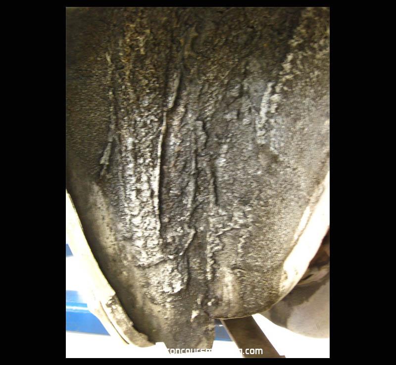

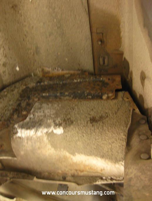

Hey sparky65 - got an opportunity to look at a white 6 cylinder, automatic, PS, period aftermarket AC,  NJ coupe today and do some investigating and gathering. With the same black top as yours in the picture.
It's a rust free Calif car (came out here when it was one or two years old)   Rear wheelwells are completely different from what you found (will post some pictures)  - body color over sound deadener similar to a 69  NJ Mach I i scrubbed and scrapped the rear wheelwells of a couple of weeks back..
And it has a projected build date of Oct 22
Cleaned the wheelwells and floors in sections and took some pictures. Might get another day with it before it leaves.
Hmmmmmmm - Just thought I would share.

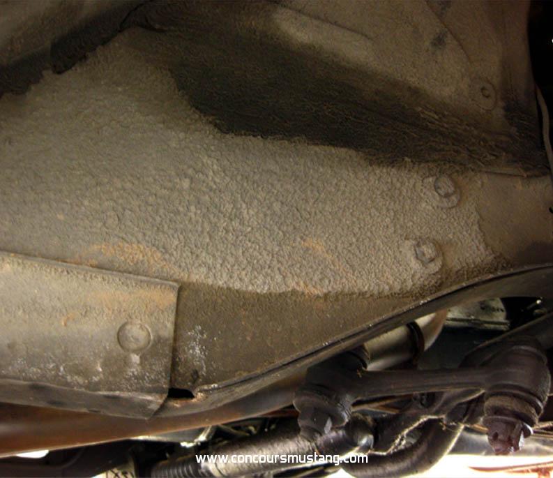

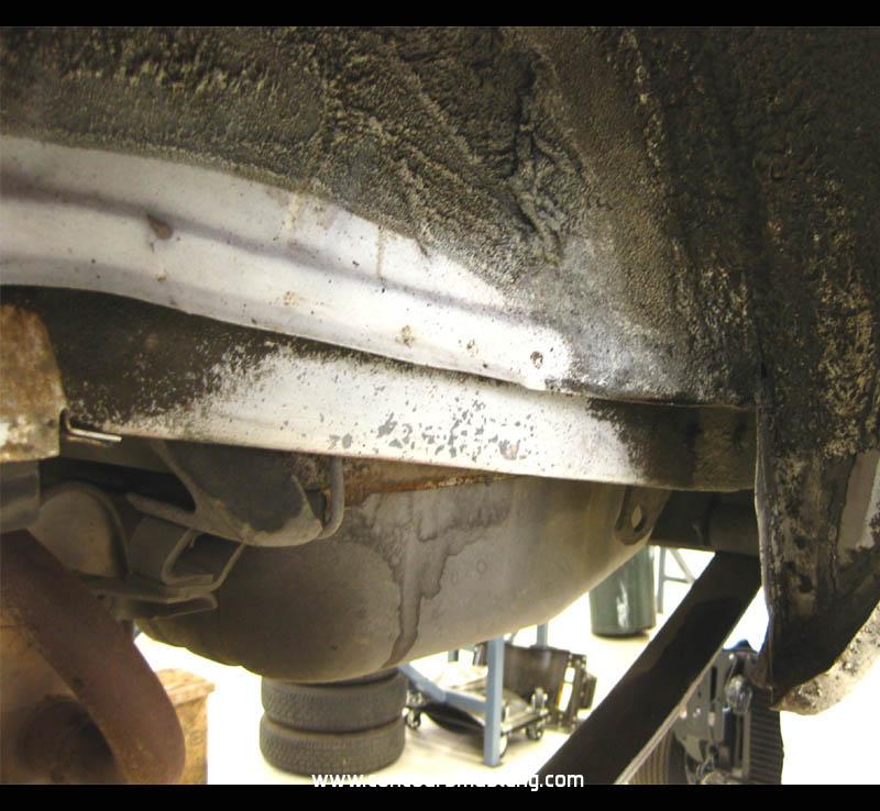

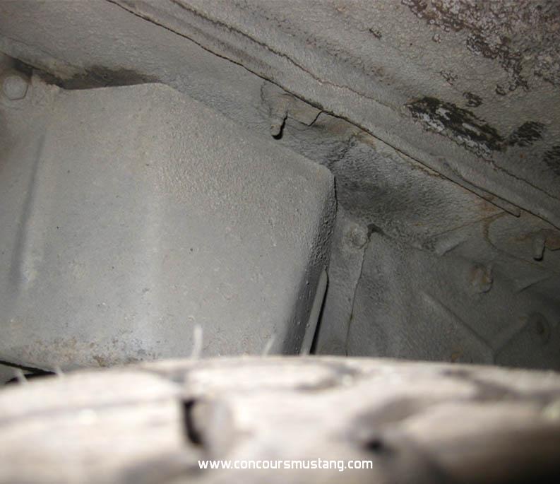

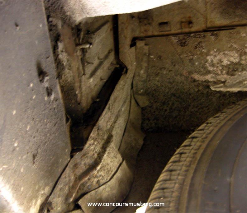

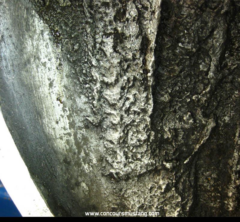

Re: Front frame rail sealer and fender aprons
« Reply #14 on: September 29, 2009, 02:42:54 AM »

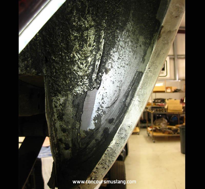

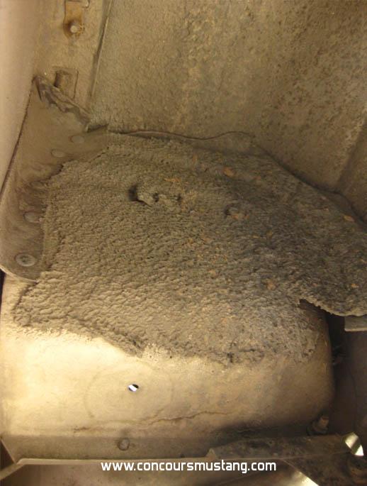

OK Here are some shots of the rear wheelwells
Also in three sections we removed a little sealer or sound deadner to determine what, if anything, was below
Rear wheel wells Drivers side - Oct 66 - 67 NJ Mustang
Front wheel well examples Sorry not as clean as the rear wheel wells
