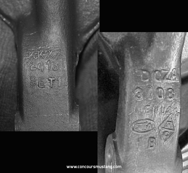

Re: 69 shelby (June built) spindles
« Reply #6 on: July 10, 2020, 10:06:30 PM »
The C8OA is not for the larger suspension .It was used on 69 Shelby's prior to the big suspension being introduced.  It has smaller bearings and also designed for the smaller tie rod ends. The number you list for BP'S spindle is the Ford part number not to be confused with the engineering number which is physically on the spindle.The one BP has is for a Boss 302 or Shelby. As I mentioned to you in a PM some Boss 302 and 69/70 Shelby's cars came from the factory with a KKX cut down Boss spindle on one side and the DOZA-B on the other side. Not all but some. It was apparently a attempt to use up what they had first. As they are the same dimensions no harm no foul.
Are there any pics to illustrate the difference between the KKX and the other big  spindle?
« Reply #8 on: July 11, 2020, 05:08:48 AM »
Not sure if there is a difference other than the markings between the early KKX and the "Big suspension" D0 versions that quickly followed
As for the difference between the regular and big suspension:
Other than the castings, a section of bailing wire wrapped around the upper part of the spindle as a quick identification for the line workers and paint marking differences it comes down the the difference in measurements of the bearing races - not something that would stand out if looking at one IMHO. There is a document posted in the 69 Library section concerning some screw ups on the line when the new suspension option was released concerning a group of cars where the parts (wrong rotors on the wrong spindles and so on)
Titled 69 Disc Brake Spindle and/or Hub and Rotor Mismatch Issue
« Reply #13 on: July 12, 2020, 04:51:59 AM »
That looks to be the standard non heavy duty suspension spindle
