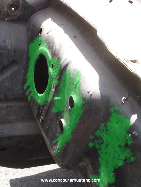

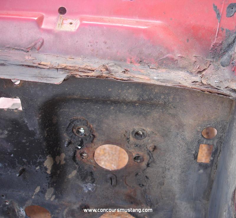

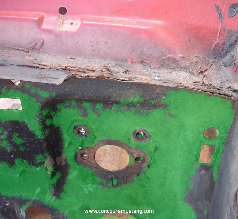

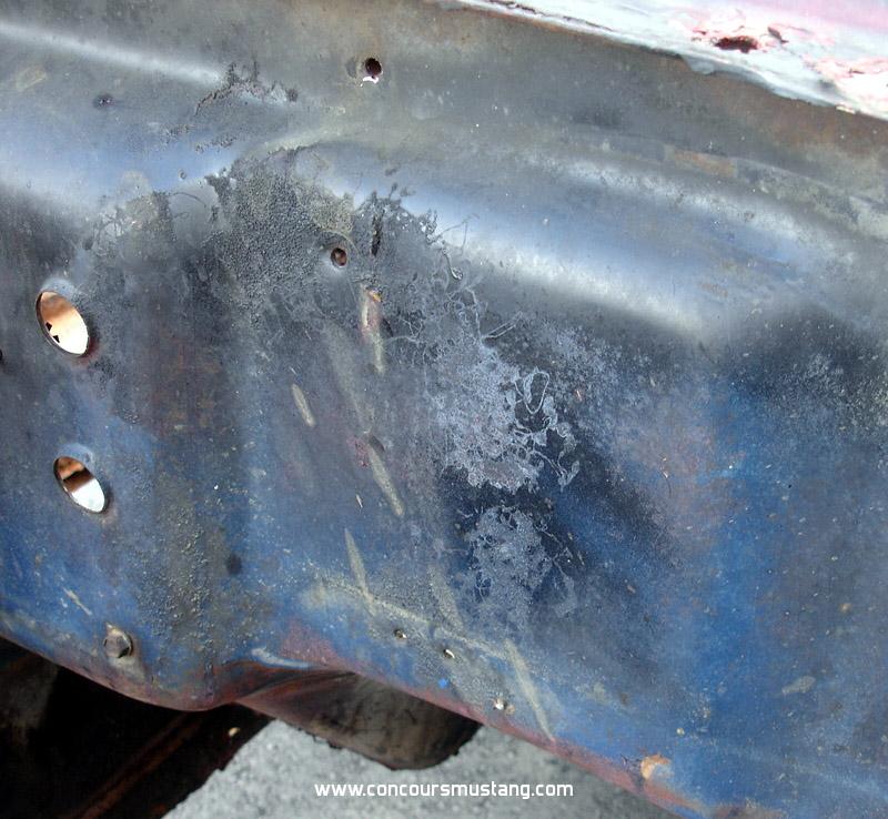

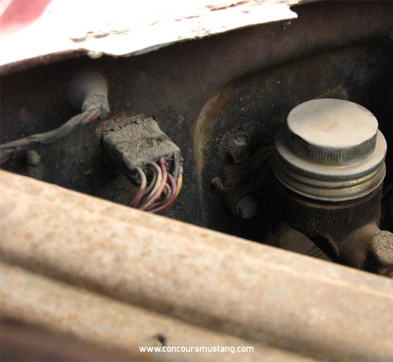

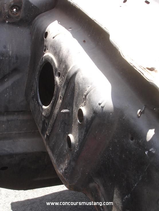

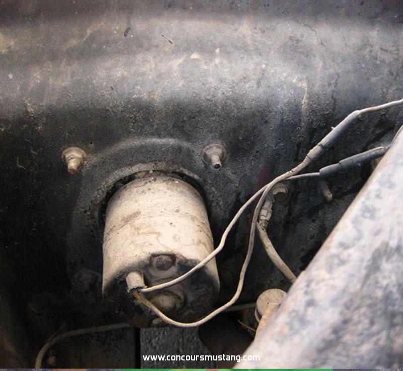

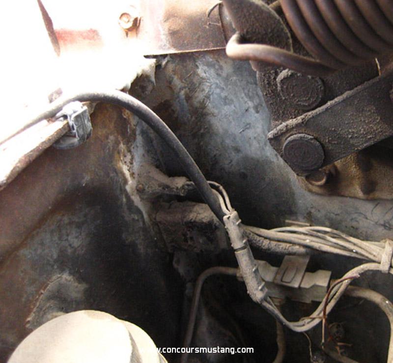

Looked through my pictures and all I have from the winter of 65 for NJ cars are pretty poor when it comes to resolution and details. Many were taken from Ebay ads and such :(
Because of this and still wishing to help out I focused on a later period where I had more examples so I offer those below in hopes that they will help and substitute at this point unless other better (closer to Oct 65) is posted.  Will post some as the original picture followed by a highlighted version as I have in the past. For some of the coverage I'm looking at sometimes more than one picture to make that determination. So multiple angles instead of just one one shown
Remember they idea was to cover/hit each of the holes or attachment points. Depended on the worker and how much effort they took on each car.
Passenger/Heater side
6T243xxx
6T251xx
6T286xxx
Center section
6T243xxx
6T249xxx
Driver's side
6T249xxx
6T286xxx
Appears that the application is not a real heavy one and the product is more sound deadener/undercoating like - different that the San Jose product, more like the product Dearborn used

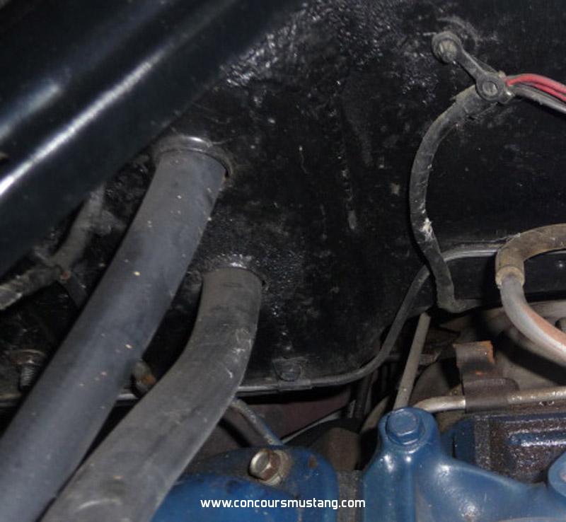

“ Appears that the application is not a real heavy one and the product is more sound deadener/undercoating like - different that the San Jose product, more like the product Dearborn used”

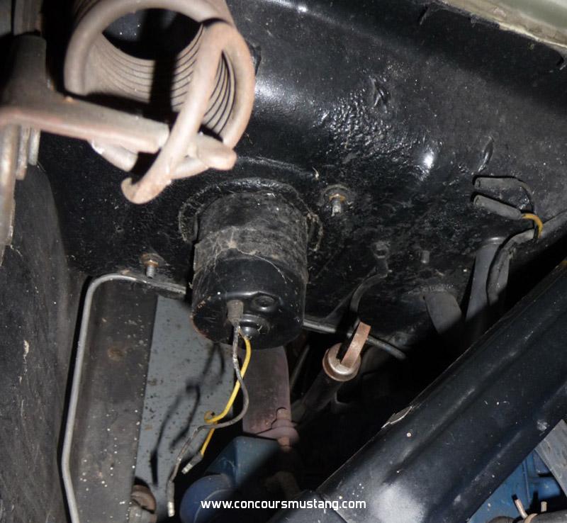

Interesting observation about what N.J. used. This is the only picture I have from my engine compartment when I first bought the car in 1980 before doing the high school kid engine compartment restoration with a wire wheel and rattle cans. The wire harness photo shown is also consistent with what I remember.
