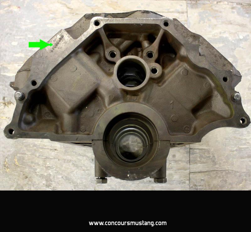

I have looked everywhere on the rear of the block and even the sides and I am not finding any Vin stamped. The date code of the block looks to be July 20, 1969 which seems a little early for September built car? But it’s better than being two months after, LOL. The heads are close to the block, just can’t remember the exact dates right now. Can you post a pic of where your Vin number was stamped?
Thanks!
Re: Would a 1970 351w 2V have a vin stamped block?
« Reply #4 on: August 17, 2020, 05:06:10 PM »
Number of examples I have. From another thread

Jeff beat me to it. Thats the place where my block is VIN stamped.

I’ve looked over this area but cannot find a vin. Is there a chance this block could be a replacement where they removed the vin, or was someone forgetful the day it was supposed to be stamped?  The block is dated 9F20 and the heads are 9F3 and 9F13, too early for a Sept build car?
