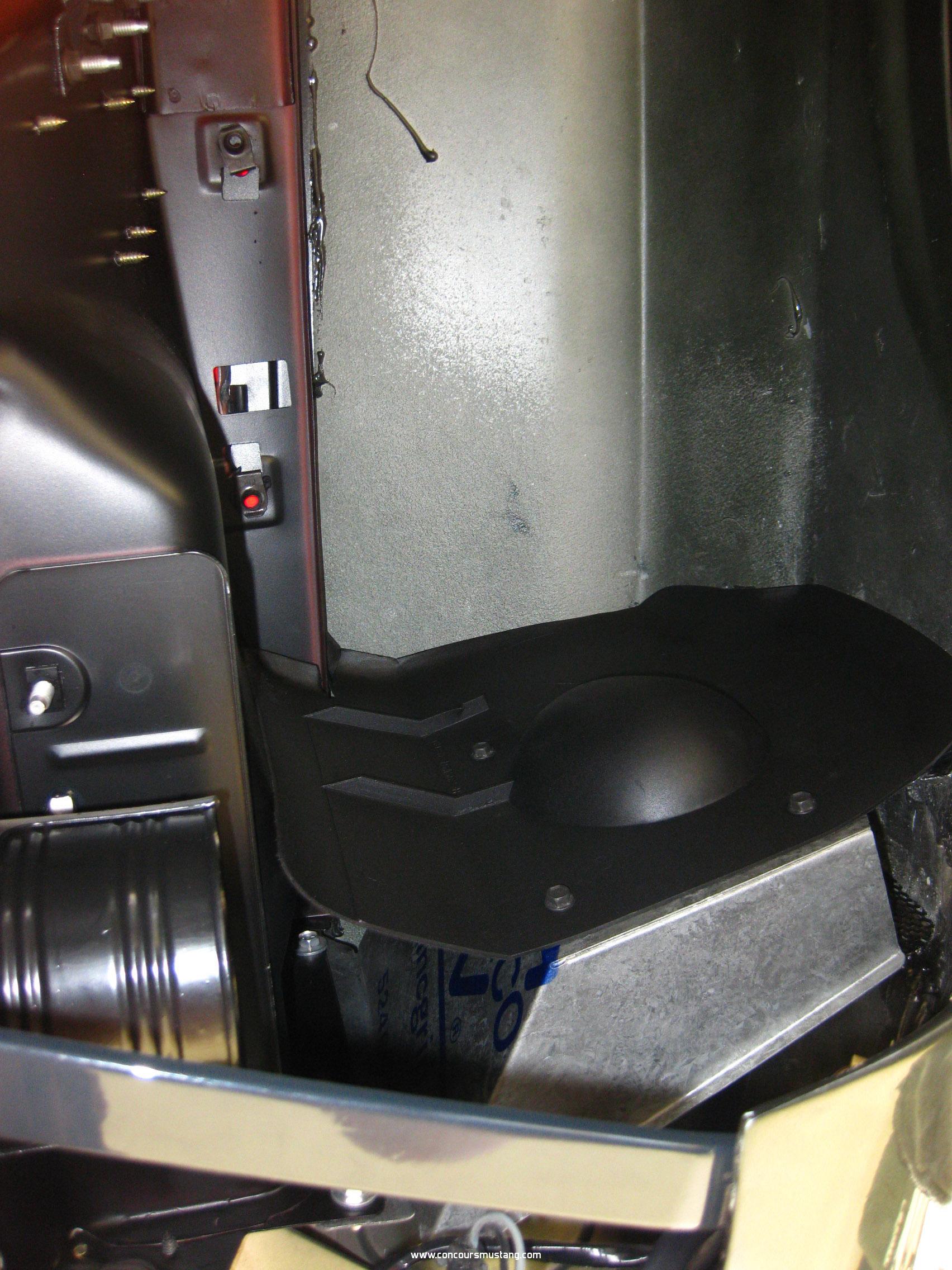

« Reply #11 on: March 17, 2023, 02:19:18 PM »
Taking opportunity to add sequential photos since I happen to be at this point of assembly.  Photos may not reflect most accurate/best practices vs. original, but i think decent  capture of orientation.  And how one rookie went about installing.
Note:  In middle photo, the two bolts that secure galvanized piece to the fiberglass bracket have not yet been installed.  I chose to put rubber washer between galvanized part and fiberglass bracket as a stress buffer.

« Reply #12 on: March 17, 2023, 04:55:06 PM »
Thanks for showing the progression of installing the individual parts
  • Posts: 9519
Re: inner fender splash shield
« Reply #13 on: March 17, 2023, 06:33:22 PM »
 Good workmanship skills . I always appreciate effort like this. With that said for those reading that may be looking for historical details It should be understood that in the first picture from the factory the fiberglass strip that bonds the lower front fender half to the upper portion is a contrasting color gray and not the same light gray as the backside of some fenders . Those pieces were separate and bonded together as part of the mfg process. . Also the epoxy glue that squeezes out the sides of the bonding strip is a darker contrast color . This detail could be a relatively easy detail to duplicate if faux finish painting. Also in the same picture when the lower valance was blacked out there was substantial overspray to the connecting fender area because it was not taped off .
