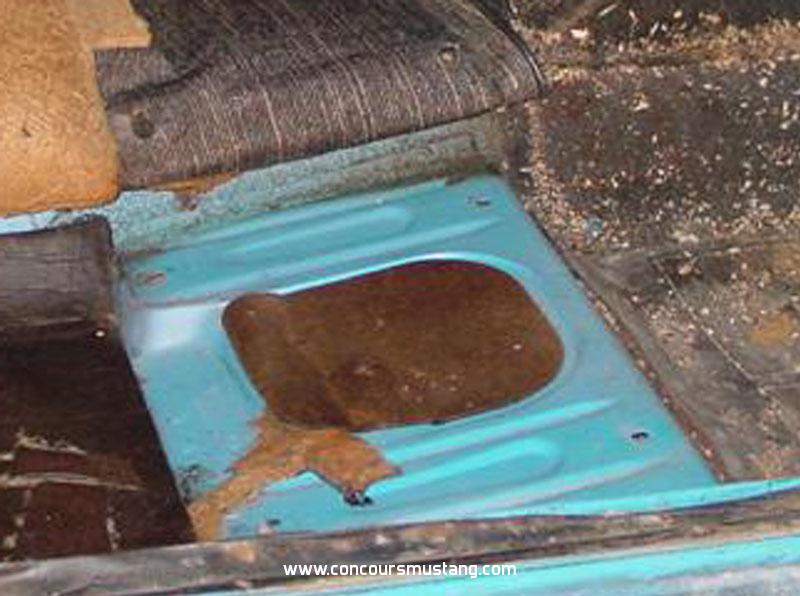

I have searched and read what I can find within this forum and yet cannot locate pictures of the *interior* floor pan / transmission tunnel area of 1970 Dearborn cars showing details regarding:
(1) What areas received body color VS which areas were only primed VS areas that saw no paint at all
(2) Which seam sealer was applied *before* body color
My particular car was built 10/08/69 at the Dearborn plant

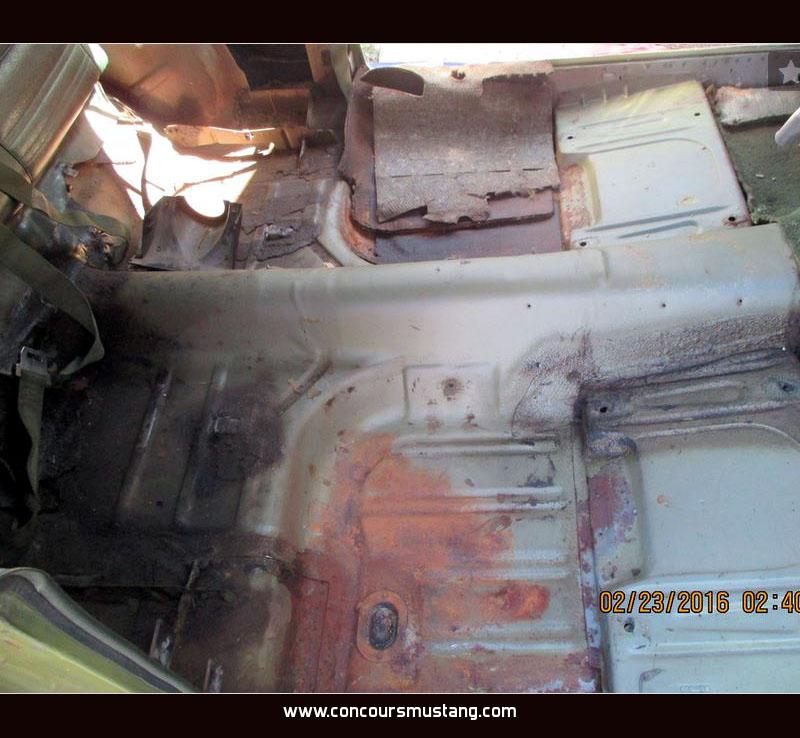

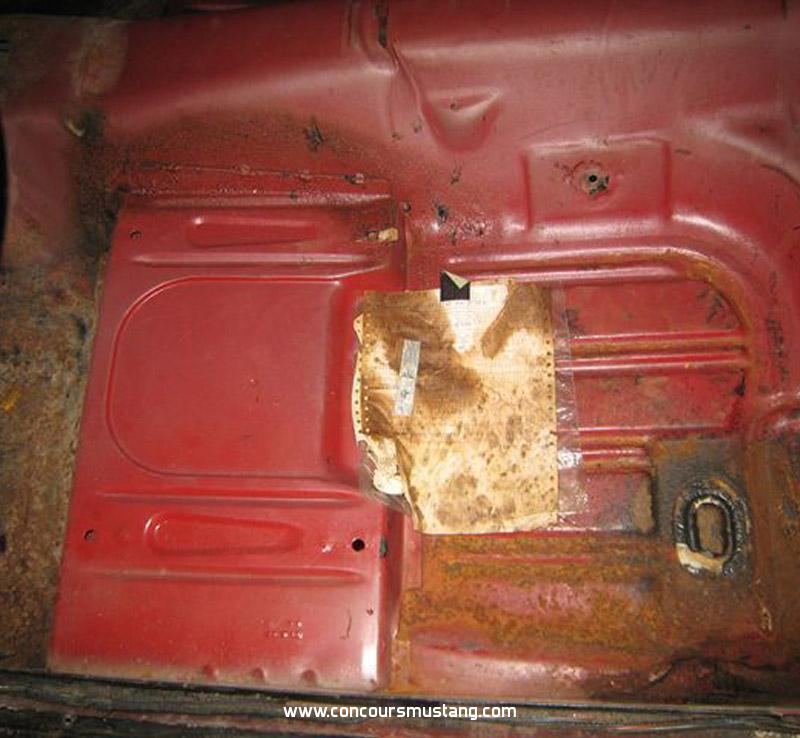

On the floor pan and transmission tunnel - generally all of that area would ahve received primer followed by body color - either by direct application near to the sill area or rain down/overspray from the paint entering the interior through the windshield, door or rear window openings. The amount would depend on allot of factors and may be heavy or light and the color of the exterior color (contrast) would also affect the final look
Not much contrast between exterior and primer sealer
Body color more visible
Did these cover the area you were interested in??
All of the interior IMHO was applied before the paint stage. The sealer product leached through the body color/overspray and the top (painted layer) worn quickly though since it was flexible
Don't for get (extra credit) little details such as the black out for the rear window defroster hole ;)

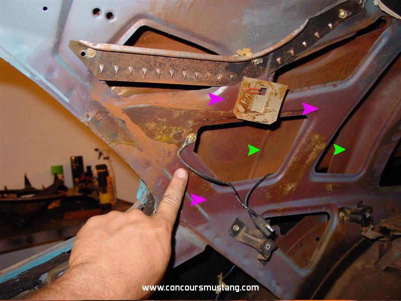

Jeff,       in the interior of a model year 1970 Dearborn car,  what color primer would you expect to see in areas of poor body color application?
For example, inside a  car, perhaps near the wheel wells, if the yellow paint was applied thin/poorly, what color primer would you expect to see?
In the interior you would find red oxide below the exterior color, overspray or where the spray did not reach or bare steel with overspray (little t lore) or just bared - eventually leading to surface rust in months or years later
Purple arrows = red oxide mostly
Green arrows = bare steel/ little paint and now rust
Note someone has already scraped out the seam sealer
red oxide is either a lighter version, results of digit camera functions or it has a light mist of grey primer surfacer and/or exterior color over it. Does appear that the painter went lighter on the this car compared to others

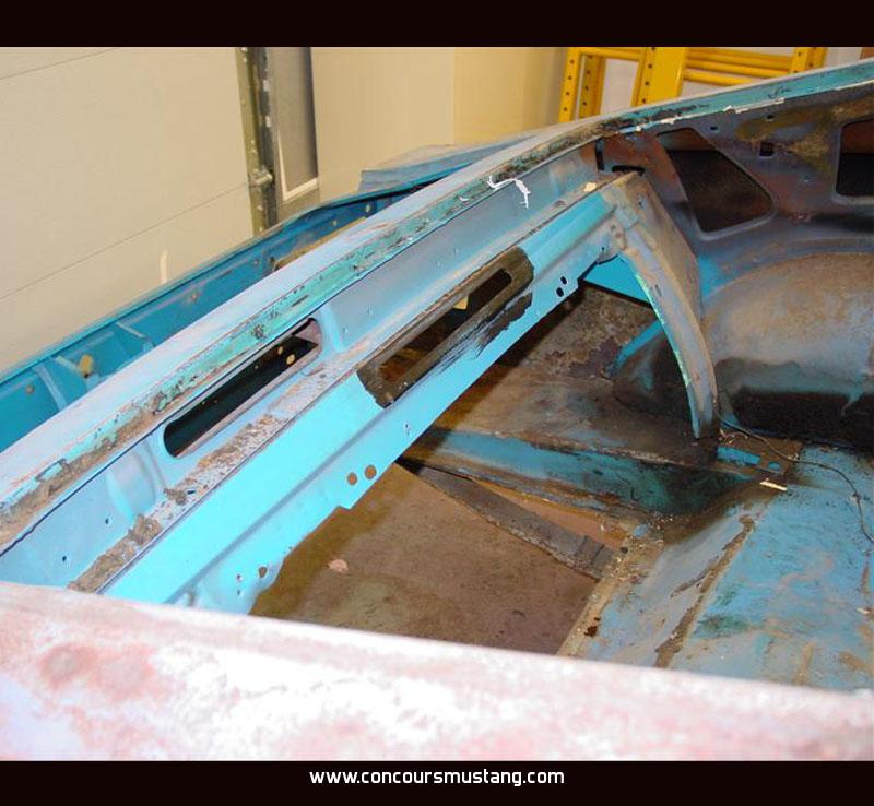

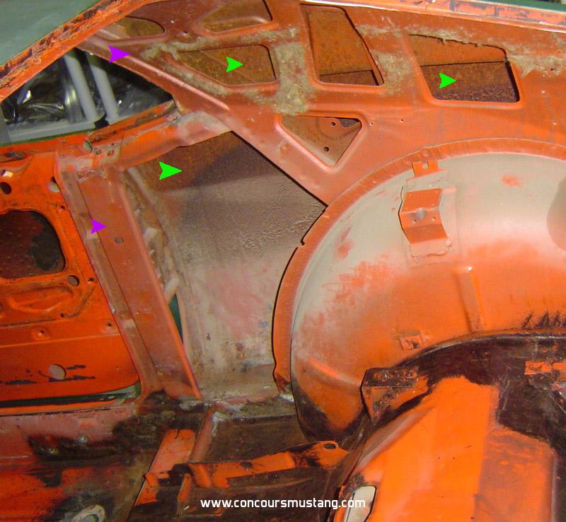

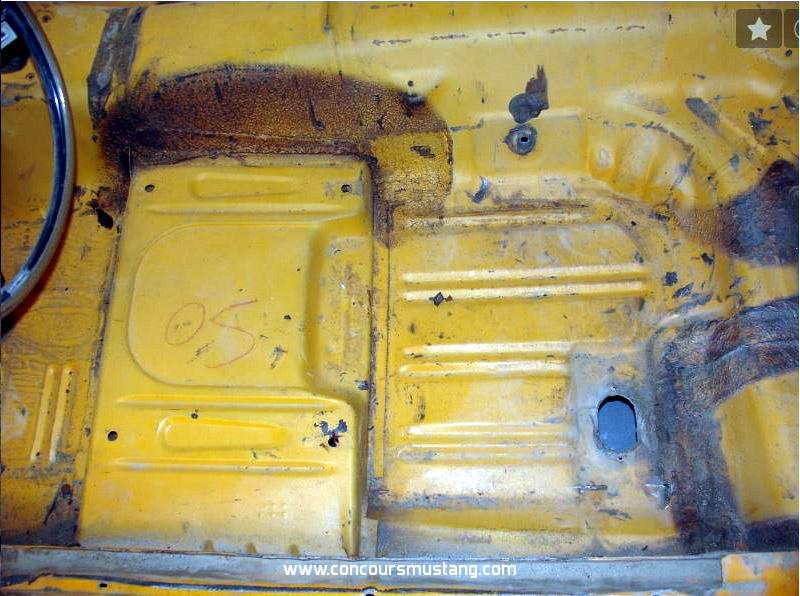

Just read the thread and have several pictures of my Dearborn built mustang with the seam sealer removed. The attached pictures showing pretty much exactly where the seam sealer went on the inside of the car and that it went down before the body color paint. Ignore the green color that was someone's vision in the late 1970's of a custom paint job over the original classic calypso coral color of the car. Hope these also help with your question #2. The first picture in Jeff's presentation above with the green arrows is actually of my car, and I was the one that removed all the seam sealer for body restoration.
