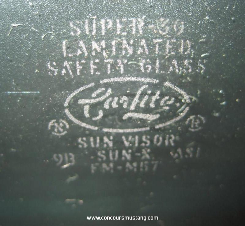

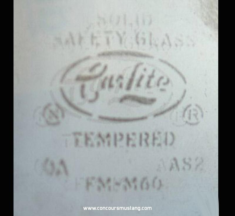

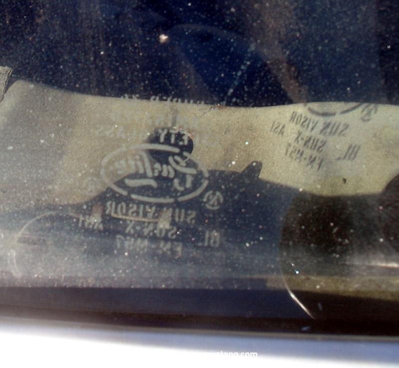

Some pictures to illustrate to others the details and markings discussed here. Just picked three with close dates from the collection. Can be difficult to get decent pictures of these details. Need to look through and find a none banded windshield from 68-69
Windshield - Sun X Sun Visor - 9B
Windshield - Sun X Sun Visor - 8L
Tempered side glass example - 9A
