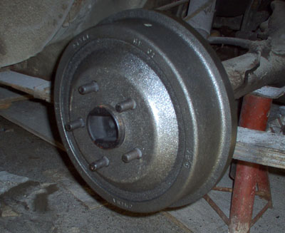

Does your rear axle look like this, the center of the drum fits over a raised portion in the center of the axle? Like this right?
I have had a rear drum stuck, the drum rusted to the axle. I sprayed WD40 where the drum and axle meet and around the studs as shown in the photo and let it sit. Then using a 6 LB. Metal Sledge Hammer, start hitting the raised portion of the axle and around the drum to try to break the drum free from the axle. Do not hit the wheel studs unless you have threaded lug nuts over the ends of them. Not hard enough to distort the end of the axle or you will need to grind down the axle to finish sliding the drum off.  In my case, the WD40 and the hits were enough to break the rust seal and I was able to work the drum off the axle.

Problem fixed. Thanks all. You can see my original K&H drums in the pictures. A little silicone spray around the hub/axle with a few light hits from behind with a hammer and block of wood and it popped off. I must have lightly press fit the drum to the hub. I don't feel any burrs with my fingers on either surface, but a little sand paper or machining will be next.

Is your car a GT500? That is certainly not a GT350 axle shaft.

Good to see the two square holes in your drum as found only on original 2 1/2" Shelby drums. Unless you have pedal pulse, grooves  or other issues I would only sand the inside of the drums. No sense in removing any material from these.
