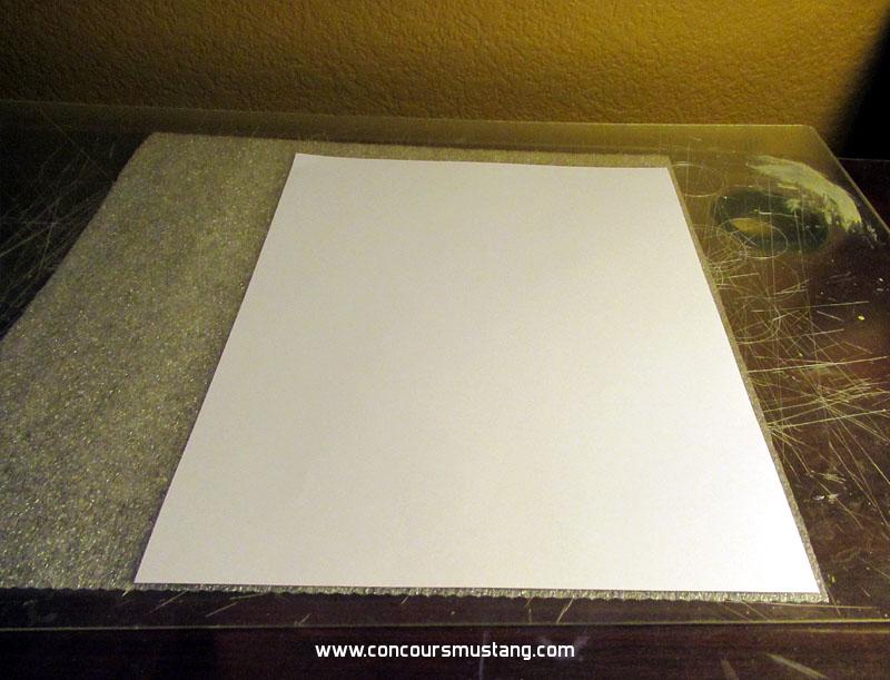

- I use a sheet of plexiglass as a base to do all my decal, sticker and hole cutting. The sheet of foam and a piece of printer paper are positioned on the plexiglass. Took me a while but I found that by placing a sheet of paper over the foam the blade would cut cleaner. Without it the foam would more likely pull and tear.
