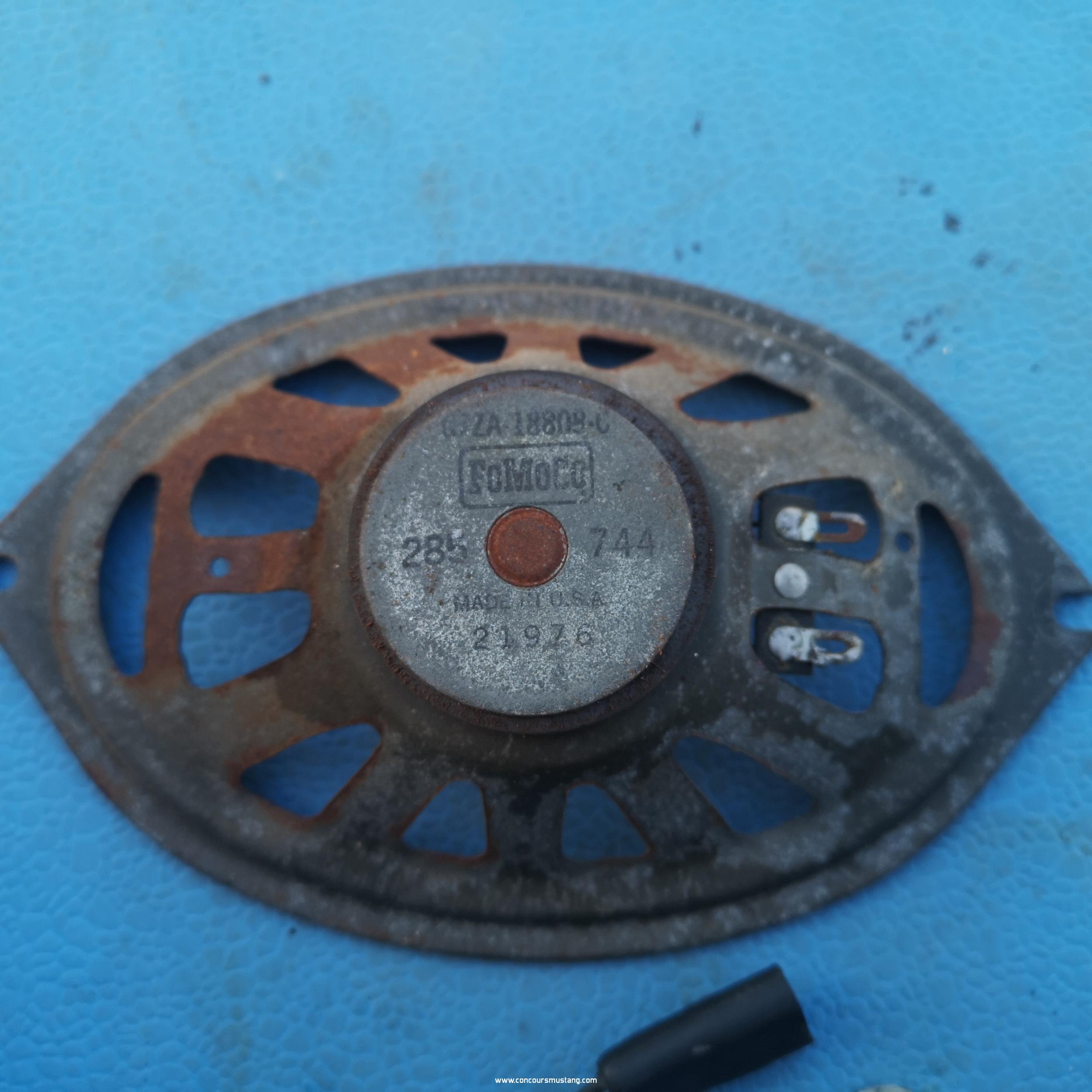

« Reply #14 on: December 05, 2020, 05:28:33 AM »
Here's a quick pic of my speaker, it's from a 68 coupe Dec 67 build, with AC. Still the C7ZA-18808-C part number.
