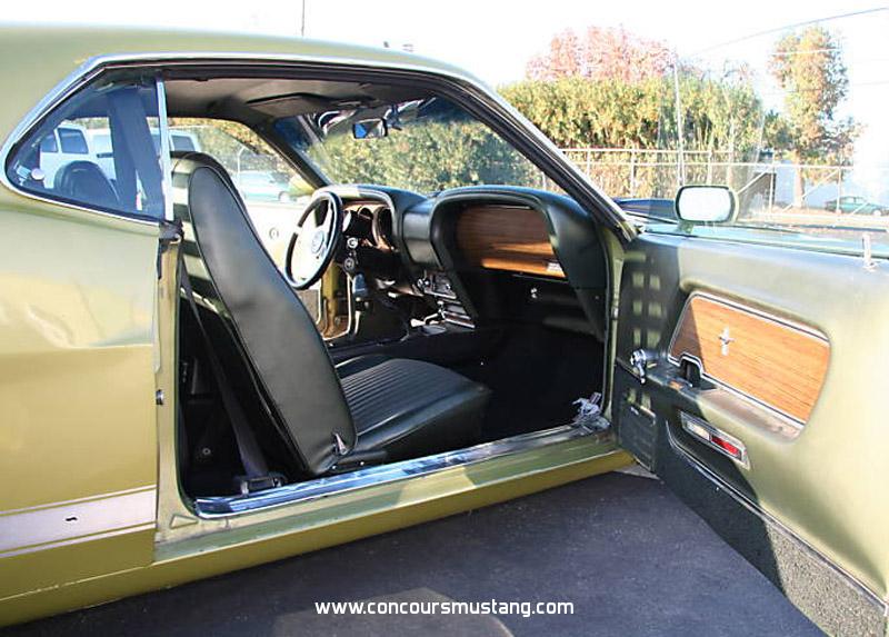

Interesting so far and with a twist. Appears that the rocker molding application may differ based on body style. What I found so far on a couple of cars that I have documentation for
Car #1  Got lucky in my search in that I had a set of pictures and a matching Marti report for the car to confirm option. Though the car has been modified with the last paint job (side stripe and individual MUSTANG letters added) it does have the rocker molding.
Car was originally sold in SoCal - the reason it has a dealer installed vinyl top installed

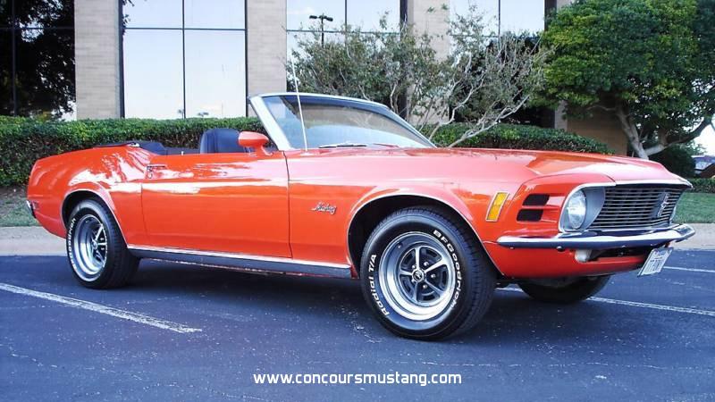

Car #2 This car I have the original invoice for and it does not state the car was order with the Decor Exterior Group. Does/did have the Decor interior though that is not listed on the invoice either. It was my wife's car for a number of years - purchased from original owner.  This original special paint (and a couple of other special requests) convertible was a great car - one of a few I would have liked to have kept
So did both cars have the Decor Exterior package or not. I owned it before Marti reports so never got one for it
« Last Edit: December 26, 2020, 07:20:15 PM by J_Speegle »

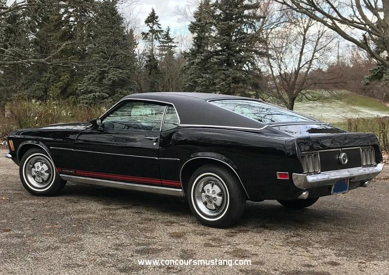

Looking at even more (just sticking with 70 Dearborn for the moment since you didn't state what production period or plant in your post.
What we may find is that it depended on when the car was built - running change where they started out including it with the package then dropped it to make more money on each car ordered the package
Additional examples I don't have documentation on :( to confirm the option or not
Well played with car

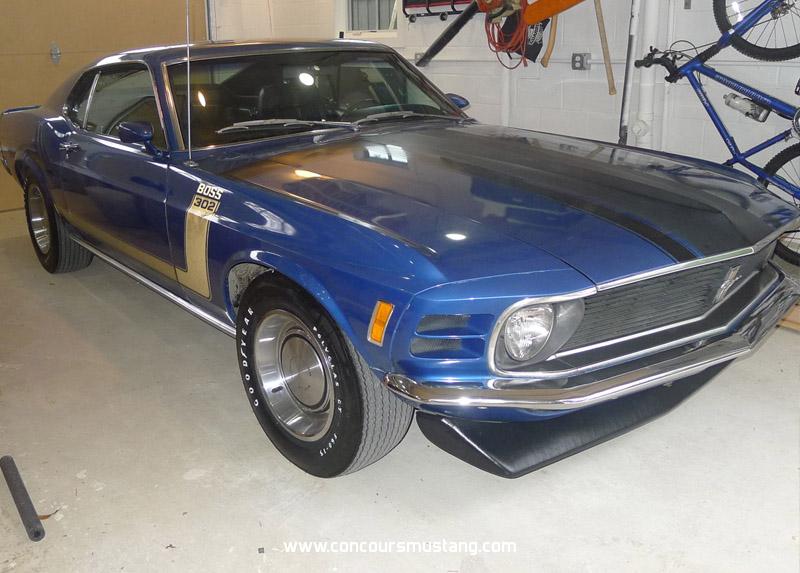

Another ???  Decor car according the the Marti report but no holes or retainers for the rocker molding
Another Dearborn car

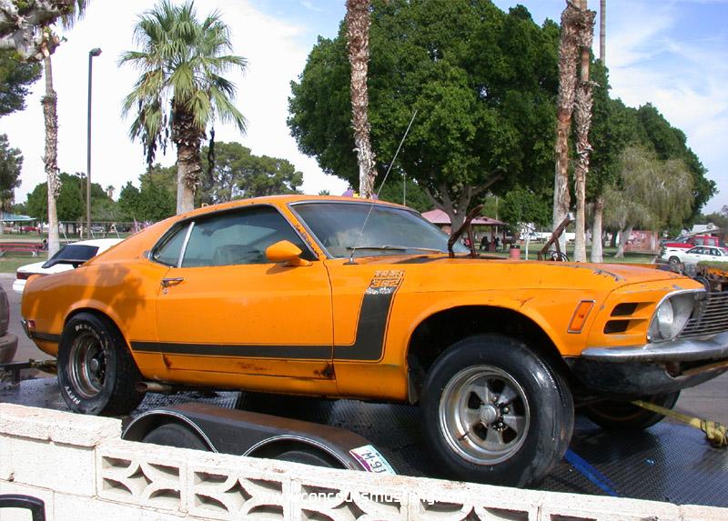

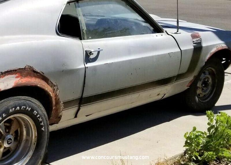

Another example with Decor Group on the Marti and no rocker molding on the car. The car being "restored" may explain what we see today
