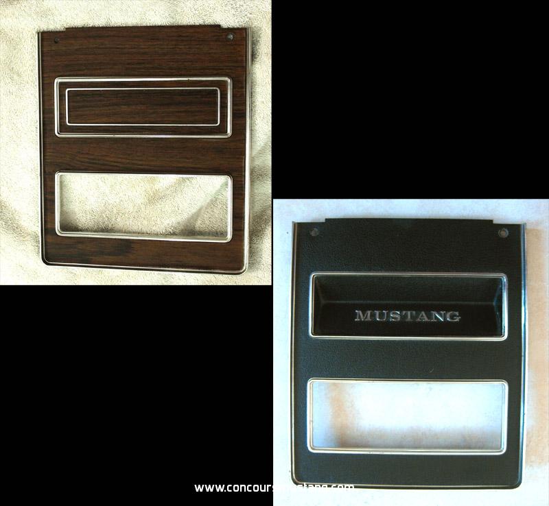

I recently received some pics of two versions of "radio delete" plates.
I believe this one is the "standard" interior, in black camera case.
PN / Eng#: C9ZB-6504302-N

Woodgrain / Deluxe "radio delete" panel.
PN / Eng#: C9WB-6504302-KW
Any idea why this part has a Cougar part number (C9WB)?  I ran it by the Cougar experts and was told that '69 / '70 Cougars did not use a woodgrain radio bezel, and that the wood grain doesn't match the grain that Cougars used in either the Décor or XR-7 trim.

Re: 69-70 Radio Delete Panel
« Reply #5 on: January 09, 2021, 01:58:38 AM »
So your contacts are saying they believe the black camera style was installed on Cougars with the MUSTANG across the radio area? Since that is the none woodgrain version
Consider that the casting number may not directly relate to or reflect the wood grain style on the face. Interesting that the people you talked to state that a radio delete panel in a 69-70 was a black camera finish rather than a match woodgrain. Believe I owned one with wood grain that did not match that did not match the Mustang straight grain pattern but didn't take a picture of it before I sold it. Which I would have now since it would be better than just a memory :)
Like often discussion of details expand to other related items. You might or not know that 69 Mustangs also used other parts through the production years that were stamped with 69 Cougar engineering numbers on a regular basis.

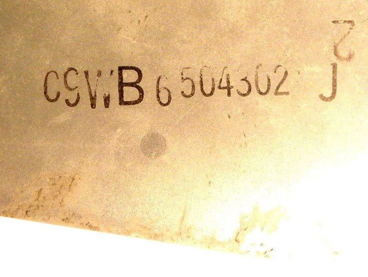

Did follow up with a look at my picture files and even though we're getting off thread a bit (can split if needed) here is a picture of one with an ink stamped identification engineering number to help. Sure someone in the Cougar community has a MPC from 69 or 70 that can look up the number
Might want to show you contacts these pictures or the thread since it can be viewed by non-members in this section. Think the grain pattern is a match. Guessing that not that many of these were made and if the plant didn't have the correct match they may have substituted something

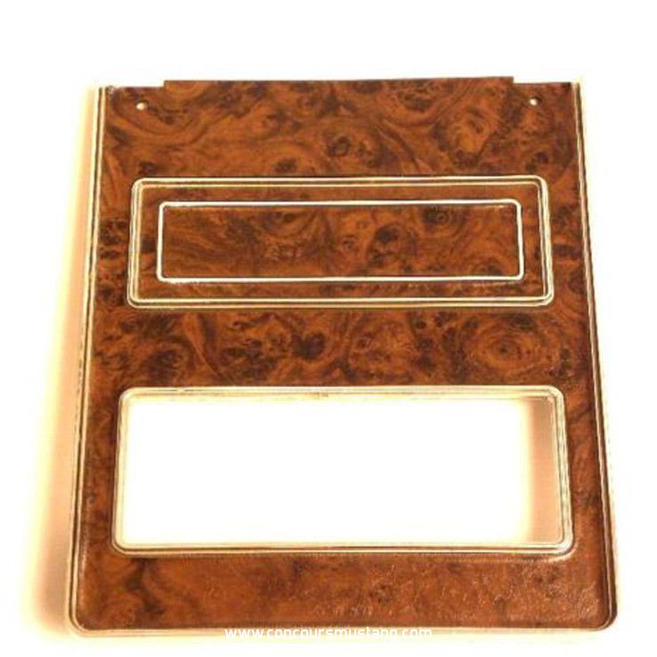

Thanks Jeff ~ not the camera case / black pebble grain with MUSTANG on it (LOL!), but presumably a Cougar equivalent.
The Cougar folks did bring up the existence of the burl grain delete plates though, used on applicable XR-7's.  Matches the pics you posted with the burl grain!
The Cougar folks did bring up the existence of the burl grain delete plates though, used on applicable XR-7's.  Matches the pics you posted with the burl grain![/quote]
Yes different base version compared to Mustang one.  Noticed that at lease one person is again looking into reproducing the plates. Not sure which version they will choose since doing both will double their costs.
