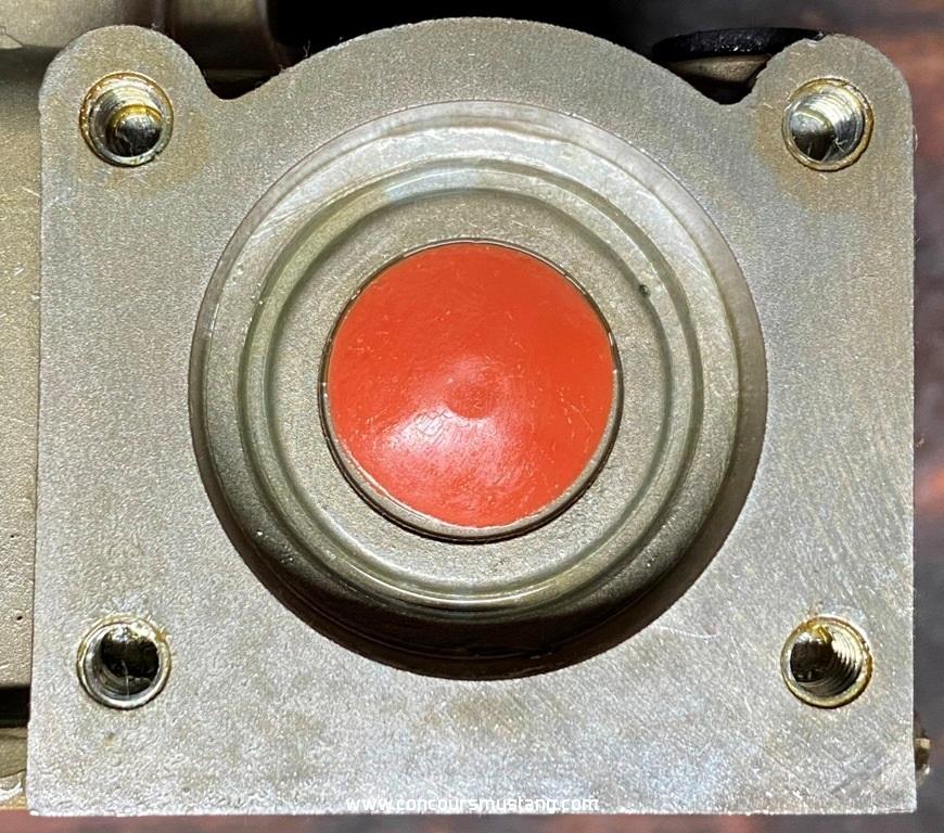

c) some of us have purchased new replacement bowls from Carl's Ford Parts. Carl is the go to guy for many parts Holley® will no longer service. Call or e-mail Holley and they will redirect you to Carl. The new replacement bowls have updated the accelerator pump system to include the Ford 2100/4100 silicon rubber "umbrella" valve. It was a Ford carburetor exclusive for decades. The umbrella valve is almost idiot proof and chemically nearly indestructible. I have never heard of a single performance issue with them with any kind of fuel mix. Ford did a real good job in 1956 including the design in its carburetors.
d) repurposing a rear bowl is another direction to arrive at a permanent solution. Secondary bowls, originals or reproductions, were made with only semi-finished accelerator pump features. A little bit of machine shop time to drill the passages required to install an umbrella valve and a path to the main body and presto a genuine 1960s secondary bowl with appropriate patina retasked to be an upgraded primary bowl.

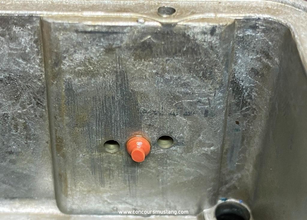

Offline Dan Case
  • Posts: 200
Typical umbrella valve installation.

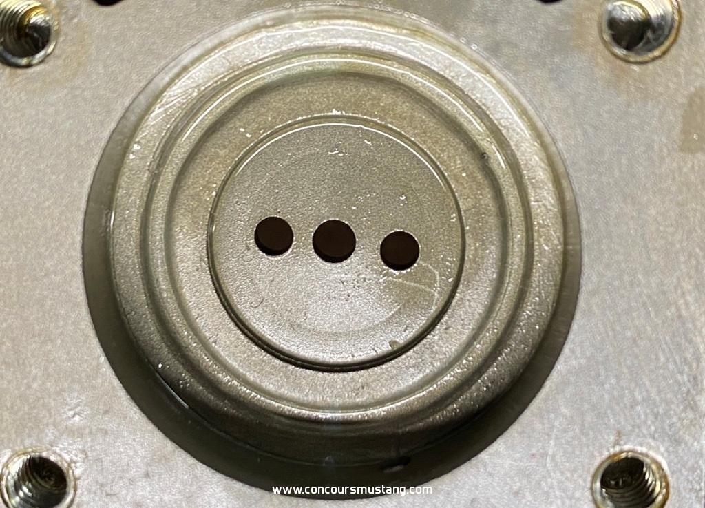

Not every carburetor shop tests for such things as leaks around that insert but some that do test have been dealing with the bypass leaking issue for years.  Randy Gillis mentioned that is real easy to machine an original 1960s rear bowl to use a rubber umbrella valve making it into a front bowl.  Several companies sell valves as singles or in groups.
I am working on a slide show that includes sketches I did of Ford Motor Company's two hole pattern under their 2100/4100 carburetors umbrella valves and Carl's Ford Parts three hole pattern.  Good used secondary bowl cores are easier to find than good primary bowl cores. I see more new old stock rear bowls for sale than fronts also. (Tip: Some rare Chrysler race carburetors used center inlet bowl systems.)
