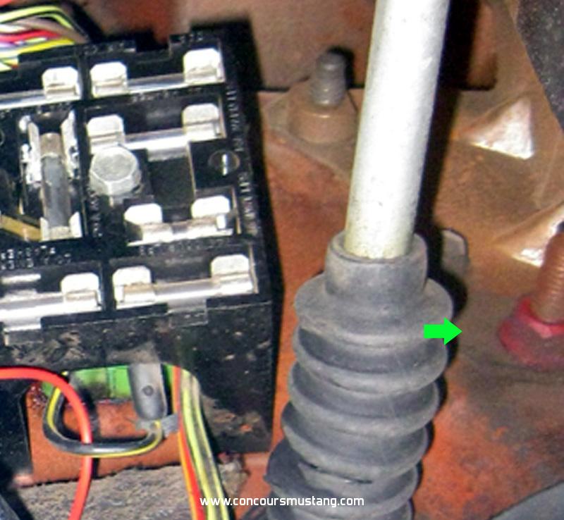

Can anyone advise what the correct attachment method that was used for the bottom stud on the brake booster on the inside of the firewall. I see there are only 4 red nuts but 5 studs and from what I can see in my disassembly picture and what I removed from the car was a notched washer like used on the bolts for mounting the steering box, and a red speed nut clip, like the green ones used to hold the rear brake drums.

Here is an example from a later (0F142xxx) Dearborn example. Hope it helps
Not as clear from the drivers side  Clutch Rod Boot is installed backwards

Excellent yes thanks Jeff, the first picture is exactly what I was looking for and is how mine originally was, I'm not sure where that other clip I mentioned came from in my bag of disassembly booster and brake paddle mounting parts. Here's a pic of my install.

Jeff s  in your bottom photo the clutch rod firewall boot is installed wrong pointing inside the car instead of pointing outward in the engine bay area and i have never seen that before so is that an unrestored car if so somebody screwed up on the assembly line .
« Last Edit: January 10, 2021, 05:19:56 PM by specialed »
Re: Dearborn Brake Booster Mounting Nuts
« Reply #6 on: January 10, 2021, 05:50:23 PM »
Correct and good catch. Since we were focusing on the brake connection that got overlooked. I have added a warning and not to that post. Would have originally cropped it out had I seen it before posting  ::)
Like many unrestored cars there is often maintenance needs over the years that can alter the car.
