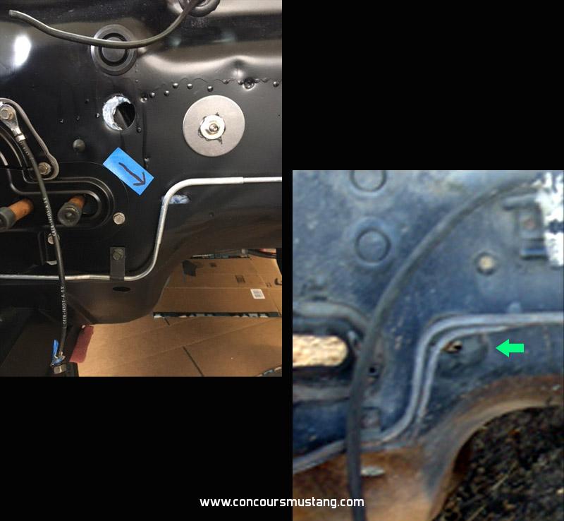

My Dearborn, Aug '69 built Mach (w A/C) has an "extra" slotted, punched hole in the middle of the firewall.  i have noted the hole "outline" on others, but they weren't knocked out (see 70 Dearborn Firewall Holes thread dated 12/07/2020).  Mine doesn't appear to have been used or plugged (which may explain the rusted front floors).  What should i do in this case?  plug? (with what?) or is there a use I'm not aware of?

That GIANT washer is suppose to cover that slotted hole. Don't use the posted picture for other details ;)

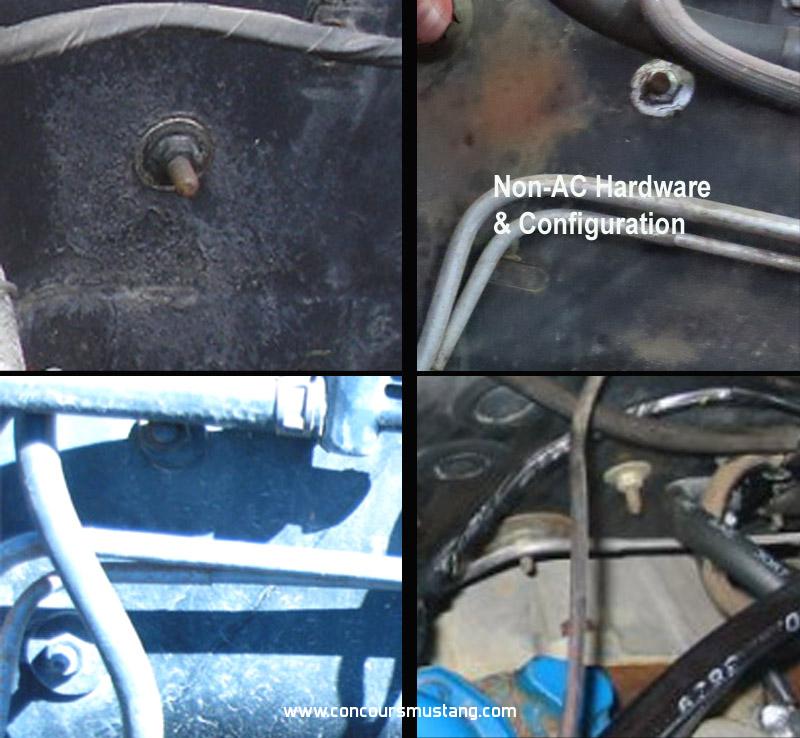

On non-AC cars that hole is not fully stamped or punched out and does not need a plug or seal
More pictures of the hardware and close-ups. Tossed a non-AC picture in there for others and since it uses different retaining hardware from the AC applications for the standard heater. That plant and year

Houston - we have a problem.....  attached are two pics taken during disassembly (I understand someone could have added or changed in the fifty yrs since the car was built, but pics are better than my memory and what was there,,,,IS a very good indicator), but the slotted hole is shown "open" and unused and the heater blower mount is shown then, in the same position it is currently placed.  Also please note Jay, that the blower mount won't work in the slotted hole without reworking the firewall mount of the cabin blower assembly (why would i rework the mount??, the inside components fit perfectly as mounted currently).  If i did move the mount and use the slotted hole, then I'd have the hole used now to plug or something.  (Yes, Marti report indicates, its a factory A/C car)
Also note that a firewall ground was present during dis-assembly, and i was always told..... "Put back what you find.... unless......"  but this would be an easy fix to remove.
So at this point, I'm considering making a metal blank and replacing the "slug".   I'd still appreciate anyone weighing in on this still   ...... I have thick skin (Texan) and appreciate the opinions of those that have put some thought into their reply.
