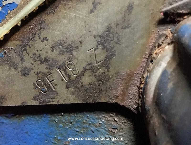

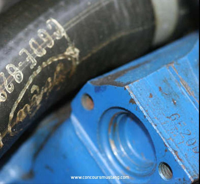

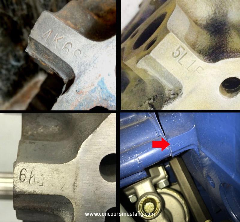

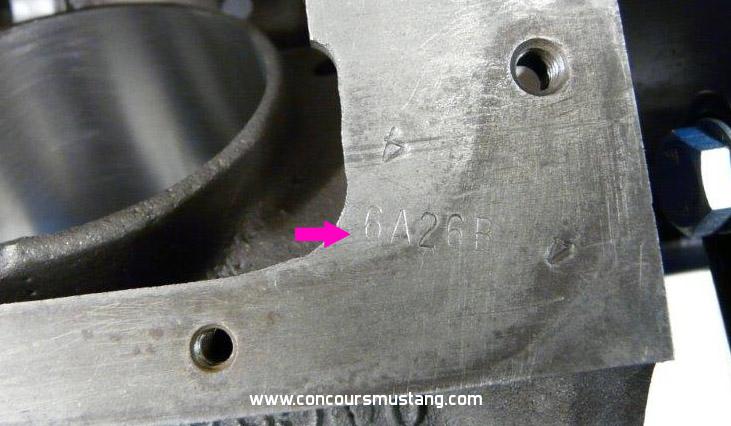

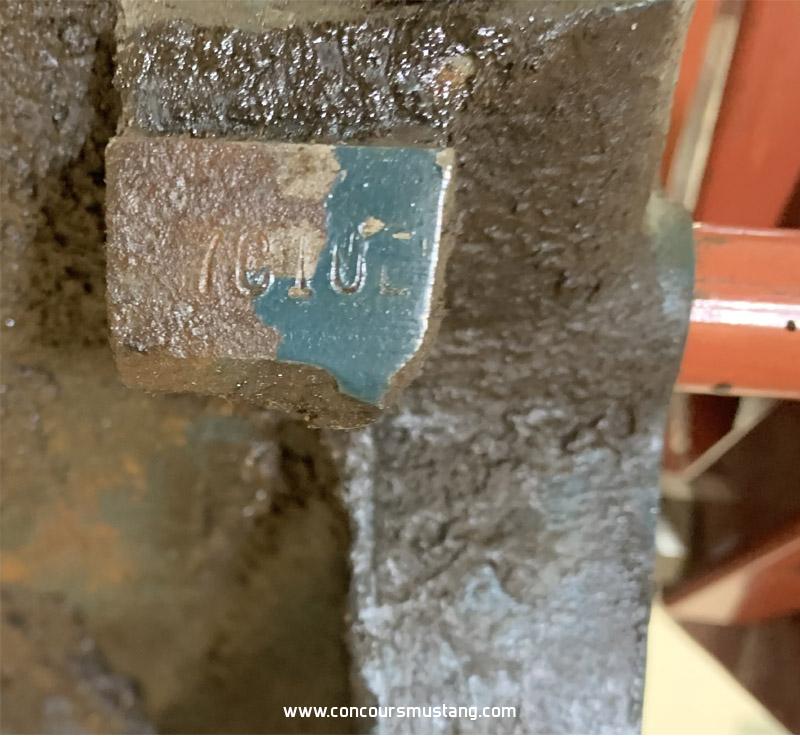

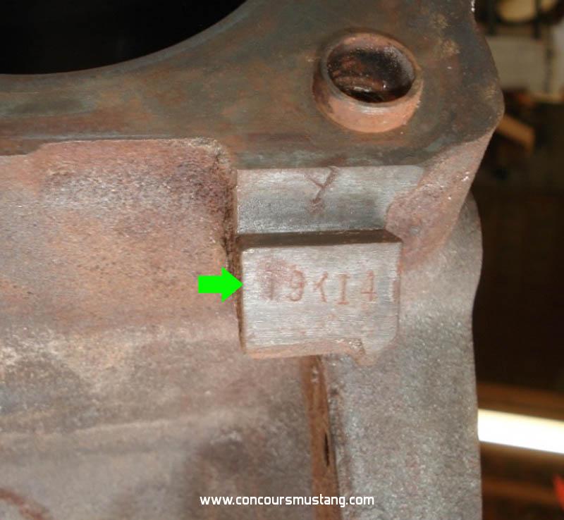

Its been suggested that we collect and display engine assembly date locations by year and engine type. Figured e could collect and discuss here then do a more formal article for long term needs. We show some in the date decoding article but don't focus on them specifically
A few that have already been shared in other threads so far
- 1964-1966 dated 289 examples (applies to all C, A and K codes)
- To start below is an example from a 1966 T code 6 cylinder
- From a 1967 289.
- 1967 S code 390. Location and pattern the same on all FE/big blocks from 67-70
- 1969-70 Boss 302 shares the same pattern and location as the earlier small block 289 and the 1969-70 302's
- 1969 Boss 429 assembly date and location
- 1969 (for a 1970 vehicle) FE/428CJ assembly date example.
Need to look for some additional 6 cylinder and some 351W and 351C examples.
Hope this helps others
