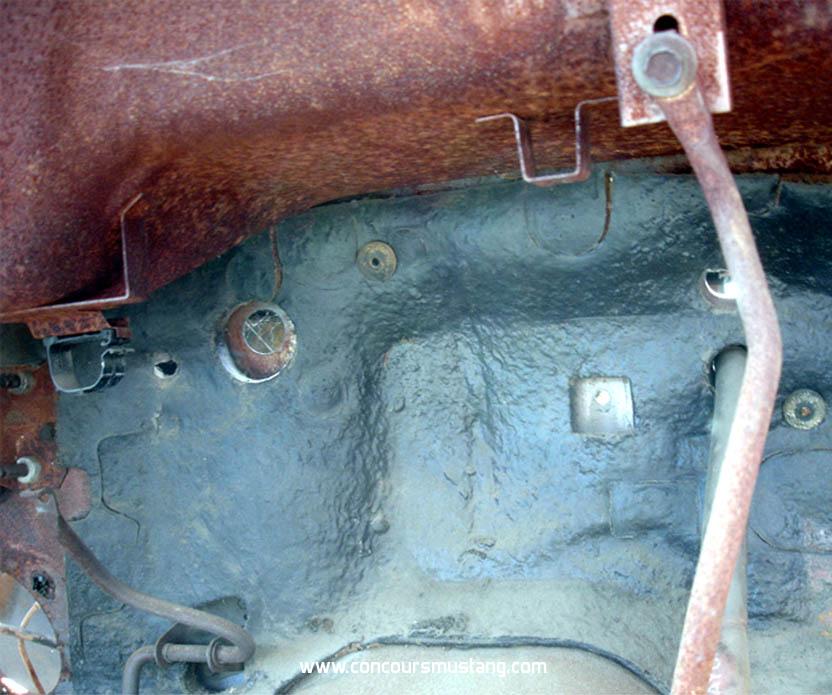

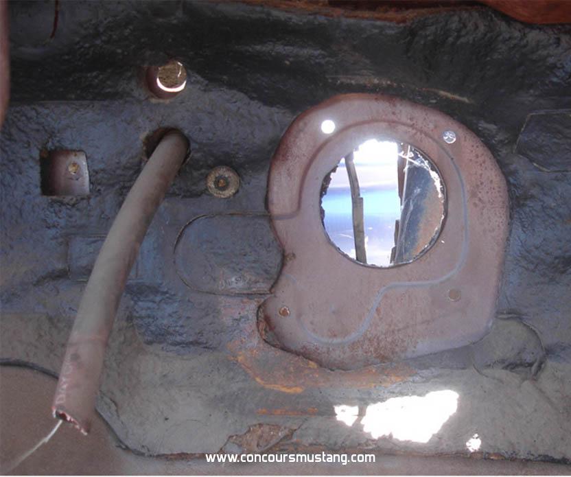

Agreed nothing close for any of the years or plants but your lucky in that your looking at 69 Dearborn and you can at least try and use the cheap reproduction and make it look much closer to an original by spraying the side towards the interior with undercoating as described in some of the threads on the site Tape the edges of openings and outer edges before applying to get that freshly cut look to the edges

Examples of the original texture
