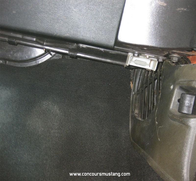

This is the location for the right side light under the glovebox on my non AC Mach1

I looked in the MPC but didn't see what I was looking for. I found part numbers and exploded diagrams, but nothing that specifically showed where it mounts under the dash. I'm not saying it's not there, but if it is I haven't found it so far. I appreciate the free resources and help from folks on this forum, regardless.
The picture that alanmac posted was super helpful and way easier than a drawing imho - exactly what I was looking for, and in the past folks have posted pictures that have been similarly very helpful.

Ref Ford Car Parts (aka MPC) 75 ed, sec 140.1 page 5. It shows the location, the mounting, the wiring, but not the same, identical lamp and bracket.
The picture shows location, which is what you initally asked. The picture does not show wiring, screw type and finish (a part number covers that) and that information is contained in the 70 Electrical Assembly Manual.

This is non a/c. I?ll update my signature, thx.
Then you should be good with the earlier picture but going to add another since I've posted it before and its handy

This seems odd. Thanks for pointing me to the right page, btw. Even in Adobe Acrobat, the search feature seems to be inconsistent, maybe because the pdf is an OCR or scanned image? In any case, on the page you referenced the lamp house and bulb do look totally different.
I was working under the assumption that the correct part was D0ZB-13707-C because I found references to that part number on other sites. I had located a NOS part which I purchased also but the part number on it is D0ZB-13K705-C. The Ford box it came in has the part number D0ZZ-13777-A stamped on it. Could that be the part number for the lamp assembly and bulb together, maybe, and the assembly and bulb each have their own separate part numbers?
The odd thing is that, regardless, the one in my car on the driver side which I believe to be original, and the one I want to install on the passenger side both look identical and look like the pictures that alanmac and Jeff sent in this thread. They look nothing like the ones in the diagram on page 5. Any ideas?

I am no expert but the light in the picture looks to be a 69 unit and it highlights the difficulty in solely working from manuals . The RH side is similar to the drivers side but it is slightly different in that the mounting tab varies in a minor way. On the drivers side the tab is slightly bent (angled) but on the passenger side it is completely flat, like in Jeffs picture. Once you have the part, it becomes easy to pick the mounting hole under the dash as it is within reach of the wiring loom.
