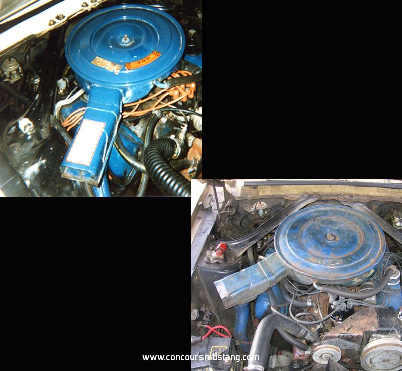

Here are a couple of original X code examples/ Upper left is a 40K mile car with a few extra state required decals added over the years
As mentioned the S code would use the same lid but with it chromed and different stickers. Not sure of the 67 comments but we can save those for another discussion :)
