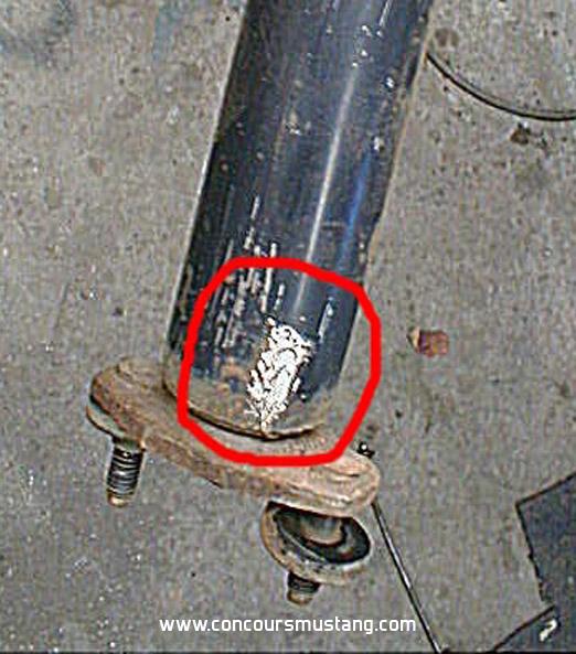

(2) Front shocks should have had a small WHITE stripe/daub just above the lower mounting bracket?
Yes front shocks. Here is an example of one that has been posted a few time here

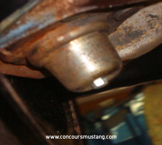

(3) Upper control arm have either a yellow or pink daub at the ball joint surface?
(4) Lower control arm has no paint markings/daubs before or after assembly. Is that correct?
Upper and lower ball joints, like in prior years would typically have the end of the stud that goes into the spindle painted yellow before they were installed so that most of the paint on the threaded area would be knocked off from the installation of the nut and cotter key

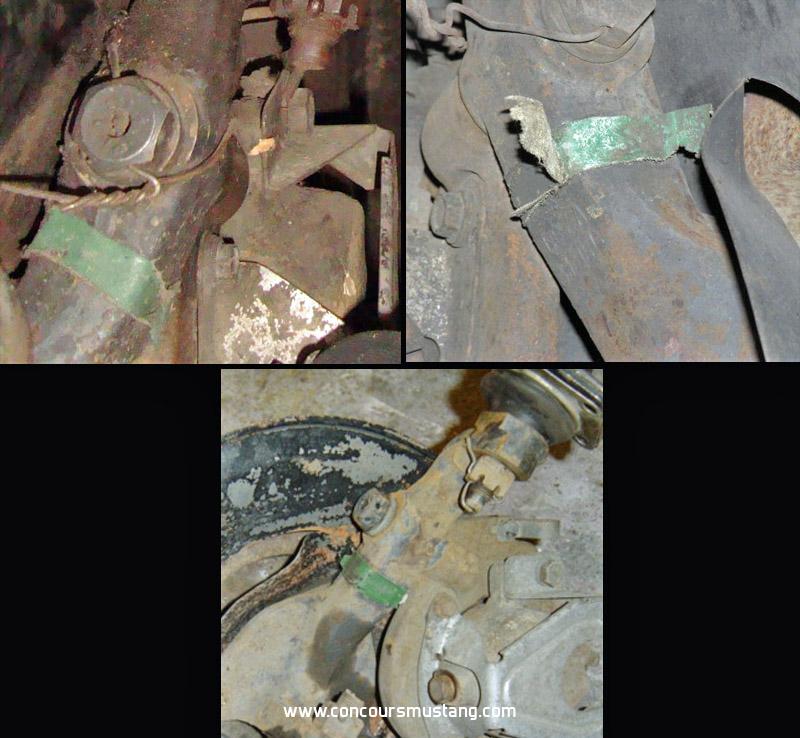

(1) Were the disc brake spindles in 1970 marked with any form of paint, daub etc marking? I've seen pictures of white stripes, yellow daubs and green tape (tape, not paint).
Yes could be more than a half dozen different markings used to identify, orientate and for other reasons. In 70 we see the first tape applications in this case the green upper spindle arm application. Other paint markings or pencil/crayon would be found near the top attachment arm (higher than the tape) at the bottom ball joint attachment knuckle, on the steering arm (one or two colors, and at the hardness test site as well as possibly a few others. Looking at buildsheets it appears that there were at least a couple of changes in the markings during the production year

(3) Are the upper control arms supposed to have yellow daubs on both the rotating shaft and at the ball joint (not the stud, rather the stamped metal surface of the control arm)?
Yes have seen the attaching rod/shaft marked with the yellow. Like from the provider like the ball joint. Though the years you can see the service replacements with different colors and markings on individual parts and these can sometimes we taken as original and incorporated into some restorations
Have seen the locating yellow on the ball joint shaft before the nut was installed but not on the a arm itself. Have seen some markings on service replacements but haven't found the same on originals. Others may have documented something differ than I
