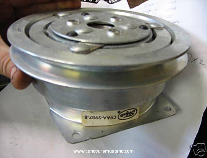

  • Posts: 9572
Re: 1970 AC Compressor Clutch
« Reply #5 on: April 19, 2021, 01:51:19 AM »
So what the clutch itself.  Should it be left black?
I have typically seen that type of clutch and electro magnet donut plated silver when new from the factory on the 69's that I work on . I typically only see the brush style clutch painted all black. I would think 70 would be similar but can't say for sure like I can on 69.

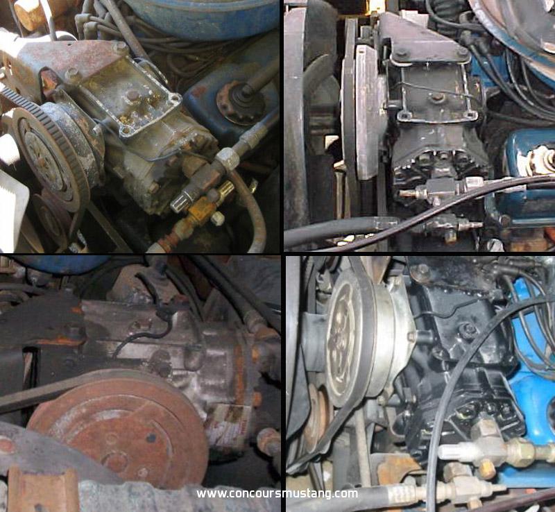

  • Posts: 24919
« Reply #8 on: April 20, 2021, 06:51:33 PM »
Here is another picture to illustrate the finish and style of clutch Bob was describing
Looking at pictures I've collected of H and M code Dearborn 70 Mustangs that are unrestored I found all with the York/aluminum style AC pumps except for one Tecumseh/cast iron  example out of slightly more than a dozen
Some of the examples below

So I am going to reopen this discussion, and ask more basic.  This might be something of an opinion question.  What is the correct clutch to start with?  Lets go ahead with the assumption that the york compressor I have is correct.  Did the York Compressor always use the doughnut type filed or could it also have the the brush type? The MPC Lists both types as possible on a 351 but does not specify a specify a specific compressor to clutch application.   The unrestored example pictures I dont think are conclusive as there is strong evidence (to me, tag/wiring clip used in 1970 is gone, compressor cereal plate is gone accept for 1, but that one is an unpainted compressor and I have not seen any other 1970 or earlier originals unpainted ) they have been altered from the factory.
Additional research seems to be that after 1970 only the type 5 "doughnut" field was used and it seems that the type 5 was the most common "service replacement" type available.  For sure that is what we see in most examples.  However, I have now found a few examples or what are claimed to be original 1970 compressors that are the York type and have the type 3 "brush" clutch.  Thoughts?
