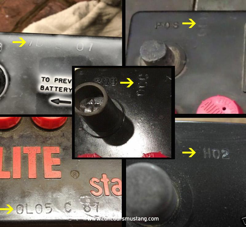

Auotlite changed over to motorcraft fall of 71 after the autolite monopoly  lawsuit. Also the OE autolite batteries had a branded type melted in date code on top by the post.
Re: Battery i.d.
« Reply #5 on: May 31, 2021, 07:49:56 PM »
Couple of different methods/styles of marking depending on production period but a few examples to illustrate Ed's comments above
