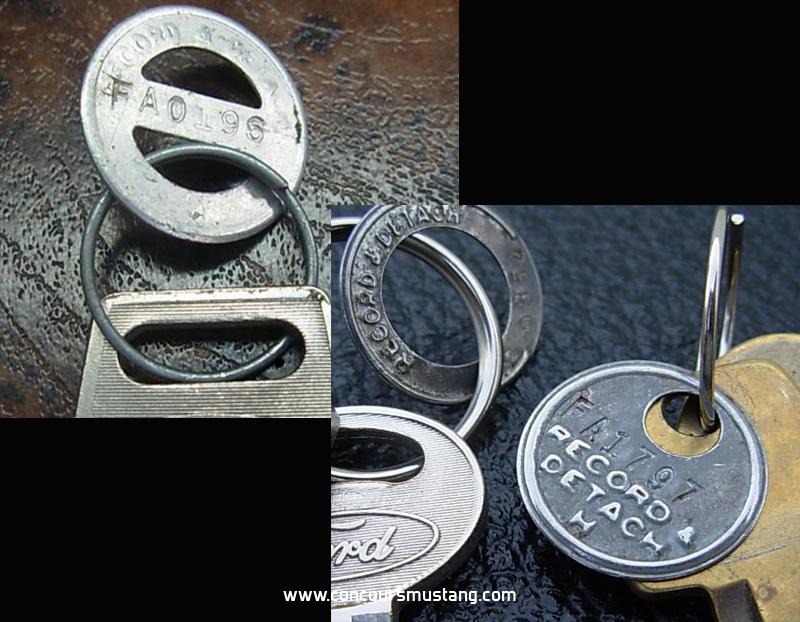

I have a Mexico Record Number and Destroy Tag. FAXXXX
The tag is shape like a bend square shape  or stretch round tag.
HOWEVER my Car is a San Jose??
I believe this is for the ford deraler to reproduce key however the MEXICO is confusing me?

Might help to see a picture of what your trying to describe. The "Mexico" may juts describe who or where the tag or item was made - reproduction or aftermarket replacement

I've not seen Mexico on the tag, but those tags are used to ID your keys so the Ford dealer could make new ones without having your old key. If someone copied that number they could get keys made and steal your car, hence the destroy notice.

It is an instruction - RECORD NUMBER AND DESTROY TAG - read it as YOU record THE number and THEN YOU destroy THE tag. The tag was made in Mexico.

Three different styles of the lock code tags from 1969

While looking up the trunk located wiring in my 65 GT Fastback for another post, low and behold, on the key ring was apparently, the original metal tag with the notation (spaces intended):
MEXICO
    RECORD
  NUMBER &
DESTROY TAG
(the number)
I'll ignore the instructions and keep the tag with the keys.
