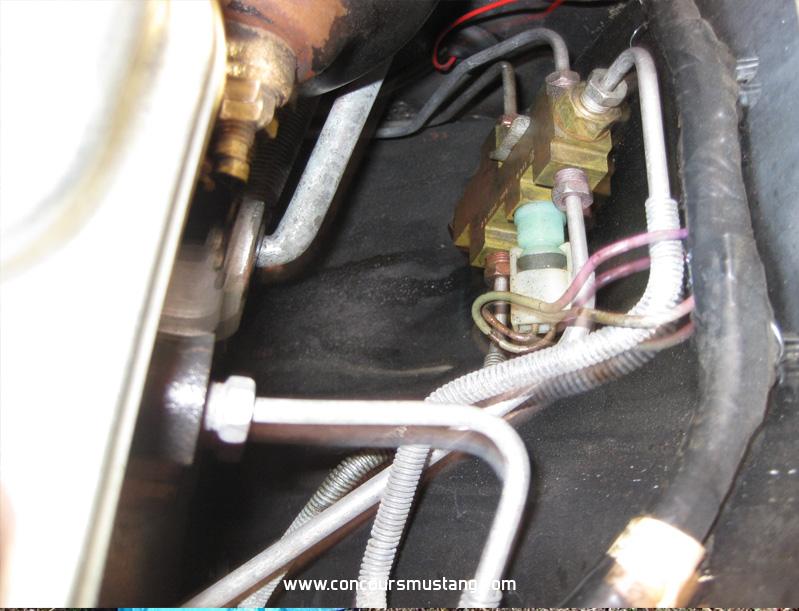

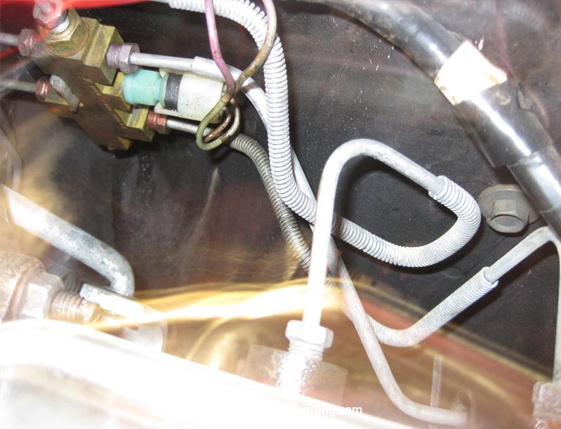

Re: D0OA-2B328-D Brake Distribution Block Diagram
« Reply #5 on: June 20, 2021, 05:07:49 PM »
Not sure if these will help but from another thread

Jeff, do you have any pictures of the firewall area, just a bit lower and towards the transmission tunnel? I'm trying to confirm precisely where the "spiral" brake line wrap is supposed to be placed on the front-to-rear brake line.  The reproduced brake lines come with these spiral wraps, yet they move around during shipping and once arrived, I'm not sure where the wrap should be on the front-to-rear brake line.... near the transition from tunnel to firewall???
