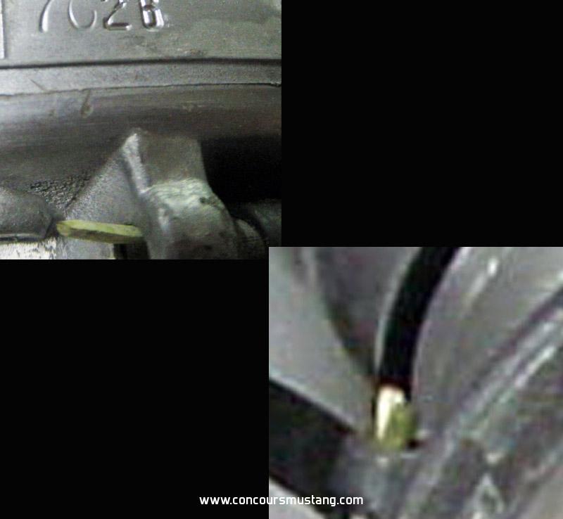

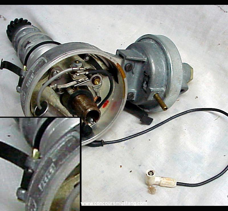

Couple more from others I've posted before. Unfortunately from the end of the pin but still shows color/coating

« Reply #31 on: August 11, 2021, 09:04:10 AM »
I think I mentioned earlier that I see similar color in a photo I have of an 0H dated NOS Boss 429 distributor, but whatever that coating is must not have survived for long in the real world.  It is a pretty cool looking detail and I have been coloring the pins a goldish color on the 1969 and 1970 distributors I have restored.  Remains debatable as to whether this is concourse correct though IMO.

I'm not saying these are the causes here, but yellowing of zinc appears to be an issue mentioned many times using a variety of zinc processes.
I think that may be why a couple of my examples turned a yellow though still not convinced (see below) - can be felt and wiped but the vast majority have the coating as shown
Also note that none of the other zinc plated items attached at the same time do not show the chalky yellowing so think it has to do with the coating rather than the zinc.
