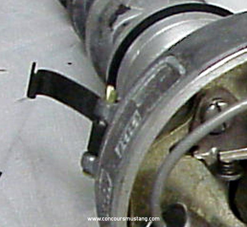

  • Posts: 24919
Re: Distributor Cap Hold Down Clamp Rivet
« Reply #9 on: July 27, 2021, 04:56:18 PM »
Ones I have on 67-69, from the same production period (not later NOS), that show zinc dichromate with a green tint similar to what we see on things like Ported Vacuum Switches and  some thermactor parts
Found this picture already uploaded
Believe I posted others pictures in at least one other thread showing this. Will look and see if I can find that thread Or I'll drag out some examples and take better shots of the head of the pin and post

  • Posts: 9573
« Reply #10 on: July 27, 2021, 10:57:33 PM »
That pin looks too green to be like the ported vacuum tree (gold/yellow chromate ) IMO. It looks more like olive drab to me.
  • Posts: 24919
« Reply #11 on: July 28, 2021, 12:54:22 AM »
Don't judge the color from that poor picture. For me its not even close to the olive daub one would see on screw clips and the like. Way too flat and think of a coating IMHO.
This is very translusant
Will provide more and better pictures once I get some examples out. Shafts should pull out with little effort so we can see more surface area. Might throw a few in my pocket and bring them with me this week when I see you
