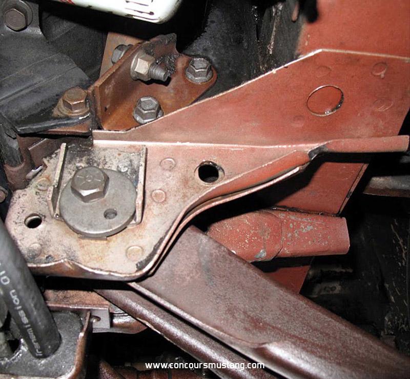

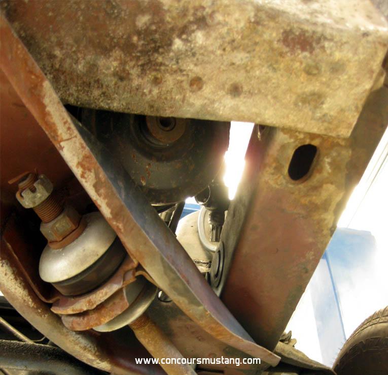

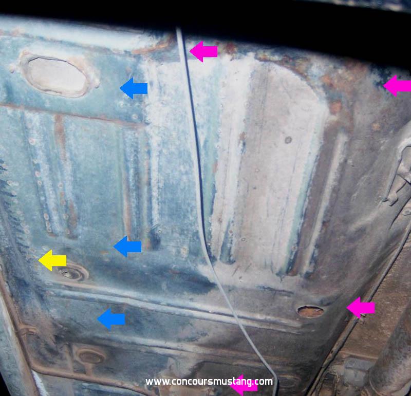

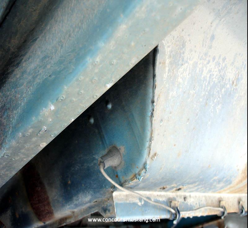

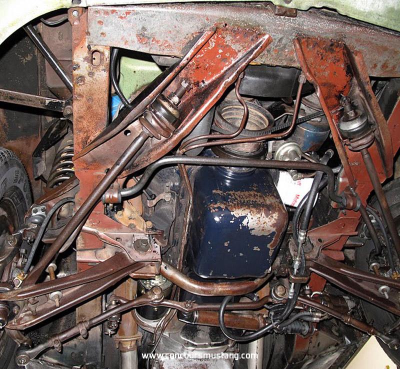

For the front frame forward of the firewall I offer the following pictures. Please understand that once some one cleans the area it is not unusual to loos 50% to 100% of all overspray due to harsh chemicals or the rags/towels used to wipe the surface or even brushes So keep that in mind as you look through undercarriage pictures especially
Pic-1 In this picture, below you will notice that the front cross member has been stripped of the red oxide colored primer sealer. Notice that in the somewhat deep frame to cross member spot welds we get an idea of how well covered and with what color the cross member originally was
Pic-2 In this example you can see where the painter dropped below the front cross member and allowed paint to spray/drift into the forward pocket of the strut rod bracket for a little distance
Pic-3 This side of the car it seems that the same did not take place, the Front cross member is really worn so in some areas there is no primer/sealer left. In some numbers you can find original cars where the red oxide painter skips or misses area. Also take not that you can barely make out the dolly mark around the large hole in the frame rail as would be anticipated
Pic-4 Paint edges are sharper than what would be expected on a new car. Cleaning has removed black overspray leaving only nice red oxide or black on near by panels. If you look around the lower a arm adjustment hardware you can make out some small area where the black paint was heavier and or not cleaned away during that process. Because of its angle to the spray gun (applied from above this area would not normally get allot of black paint with a quick pass designed to focus more on panels in direct view of the painter.
Pic-5 Overall shot of the bottom of the front of the car from below. Again this area has been cleaned and some coating/product has been removed during that process
Also provides a general area, would guess that it would be give of take approximately a 6 inch range of where the red oxide primer/sealer transitioned to the floor color

Ex-1
From another thread
Yellow arrow - Pinch weld black out overspray
Blue arrows - Exterior color overspray
Purple arrows - Batch floor pan color
