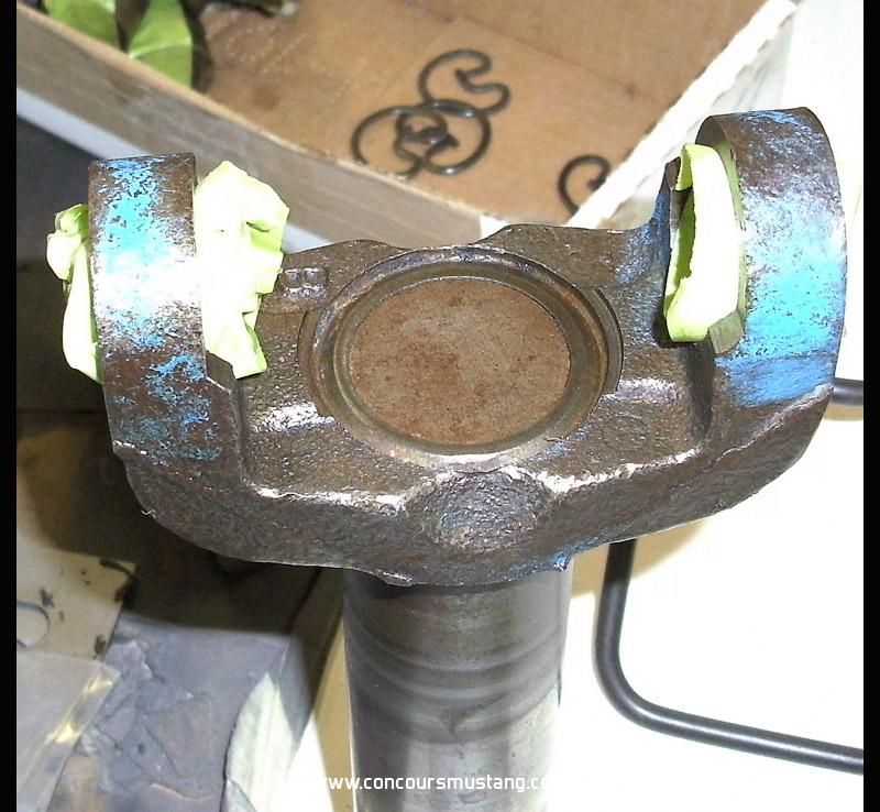

Thanks for sharing the stripe colors. Confirmed the two I was missing in my pictures
The front transmission yolk is indeed a light Ford blue and the fixed yolk is the same color as the rear.
Another example that was supplied to me of the same york and mark

Jeff -- I see it also has the 'B' on the inside like mine.
