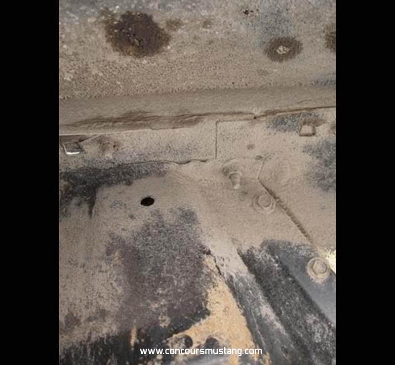

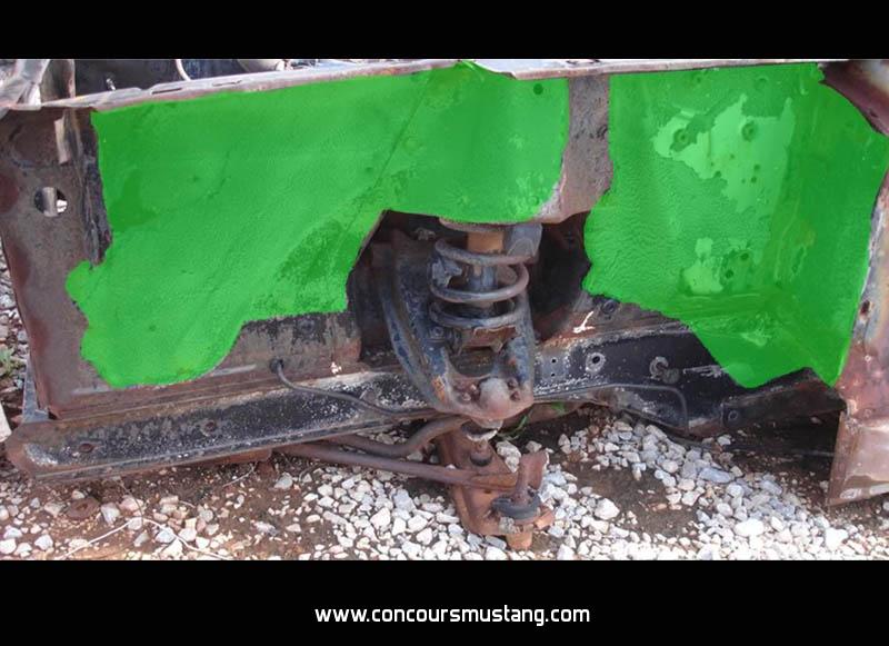

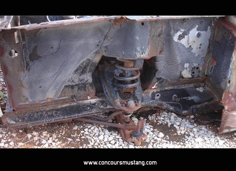

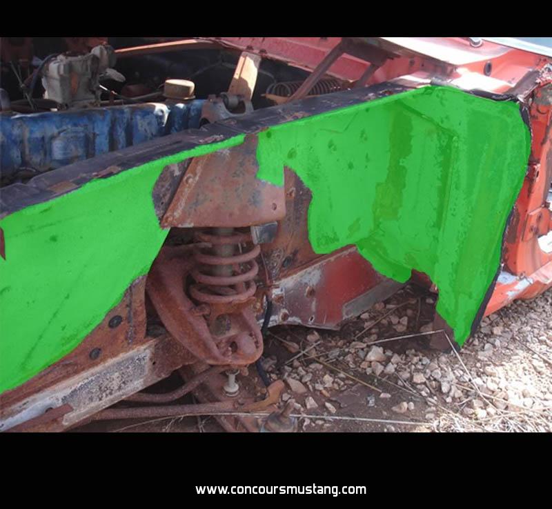

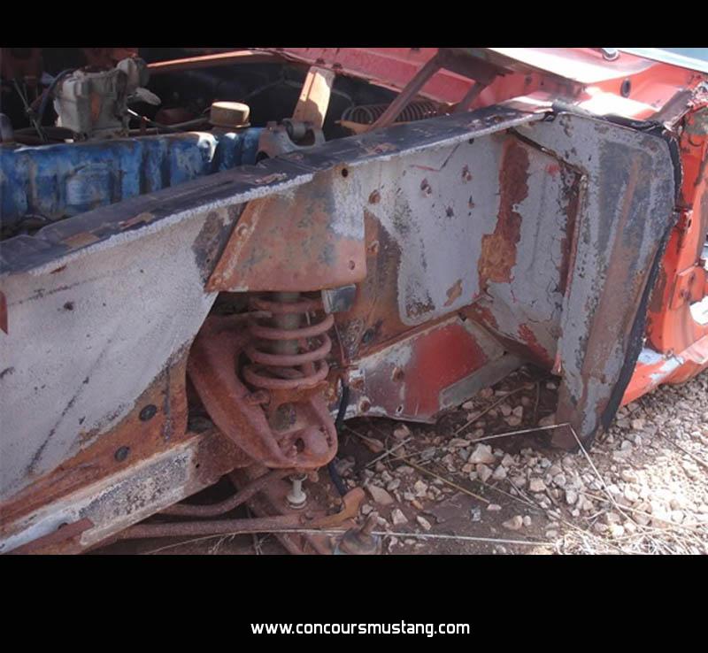

Yes the splash shields were in place as was just about everything else (fender, suspension, front spring cover...) when the sound deadener was applied
Patterns can vary depending on who applied the stuff and where they were standing at the moment. But i does appear that Dearborn was more consistent in their patterns than San Jose (for example)
Picture of the forward edge of the opening - splash shields and bottom side of fender shown also

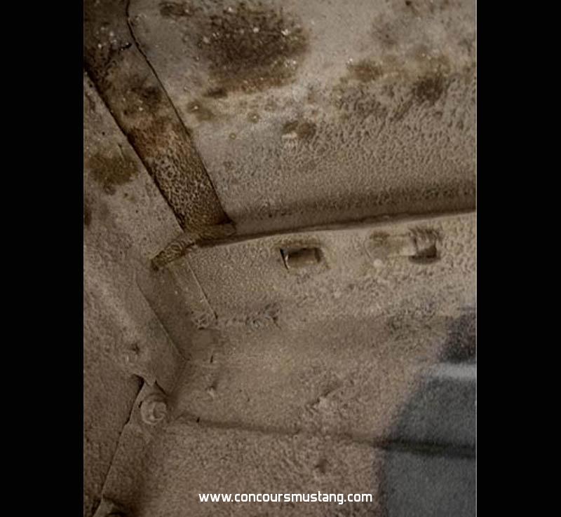

Mid way back - showing the amount of texture and areas covered
Two examples (one each high lighted where the sound deadener was applied to show the pattern) It appears that in one case the worker stood to the front of the opening and one time from the rear (notice the pattern and shadow of spray on the spring cover)
