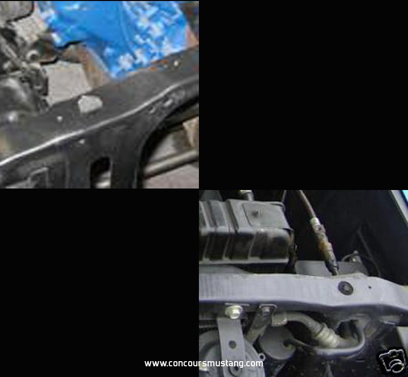

Took some time to assemble some data. Guess we should also make mention that there were two holes on each end of the radiator support on those cars with the feature. One for the hood pin and one for the cable attachment.
Couple of pictures showing the holes and locations of them
Below is a list of VIN's (missing the last digit) of my findings. The ones followed with an "N" are ones without holes. All cars are sportroofs and there is a mix of unrestored and restored cars so it is unkown which may have had prior (to taking the pictures) repairs or replacement of the radiator support.

Jeff. Wow thanks for the big dig.  Would you agree your sample size and findings are enough to conclude both with & without hood pin holes was possible.
At this point no. My examples (sport roofs) without holes can and may be all cars that have had some work done to the front and the pattern does not reflect a supply problem or a possible worker issue. May be just, in some cases, so if that is it the question if one should include a detail in your restoration that reflects something Ford didn't want to happen. Been discussed many times. Just my thoughts on the subject at the moment
  Perhaps technically not wrong either way?unless vin-specific evidence or knowledge was known about a particular car?s born-with info ???
Would suggest that like a bunch of things this is not a stand alone detail and should be considered with an examination of radiator support attachment welds and sheet metal date codes.
