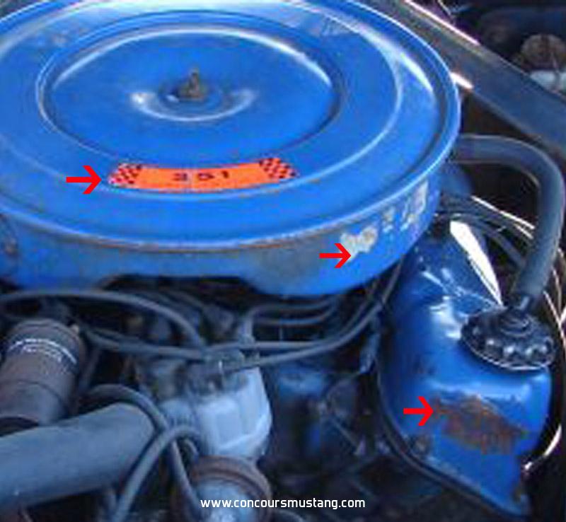

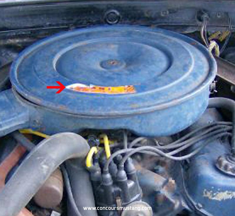

- Air cleaner lid - Cubic inch - top of the air cleaner lid/cover
- Air cleaner and filter - Drivers side of the air cleaner base at about 5 o'clock if looking at the engine from the front of the car

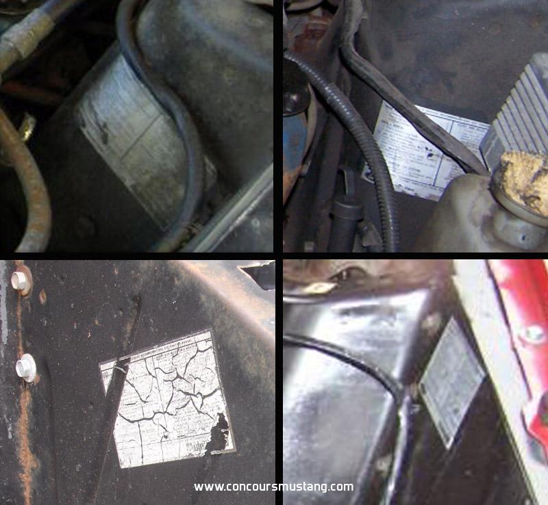

- Service Spec sticker - During your cars production period found them on the drivers side shock tower or on the inner fender panel between the shock tower and radiator support

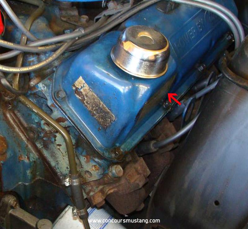

- Engine emission/timing - Drivers side valve cover below the breather cap on the vertical painted surface. Please ignore the owner alterations.
- Engine ID sticker - Drivers side valve cover on the forward face
Picture of both air cleaner decals as well as the location for the engine ID one. Same location for the ID sticker as in the example above

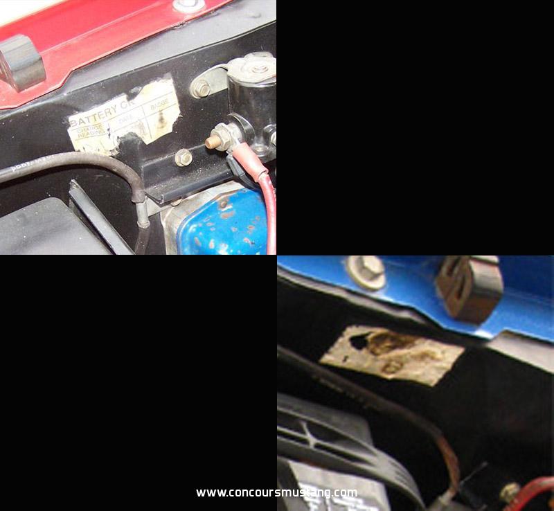

- Battery inspection sticker - Above and to the rear over the rear edge of the battery location on the inner fender panel
