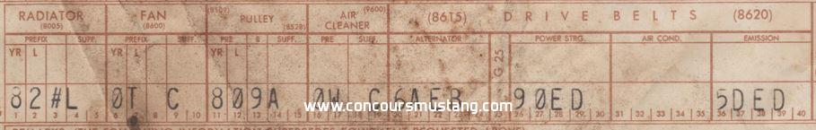

I was checking over on https://www.428cobrajet.org/id-fan    to see if I've got the correct fan and fan clutch.  My car is a 1970 Mercury Cougar Eliminator with a 428 CJ, 4 speed, no A/C.  It was built at Dearborn on Sept. 29. 1969.
www.428.cobrajet.org says the build sheet clearly identifies which fan my car came with.  The build sheet says "0T C".  That's not real clear to me.  LOL.  It's got an aftermarket flex fan on it now.  I've got a box of parts that came with the car and I believe I've got the original fan.  It's stamped "H C9ZE-E".  I believe that is the original one but I wanted to ask if anyone can decipher the "0T C" from the build sheet?
Next question would be is this something I can rebuild myself or who do I send it to for rebuild?
« Last Edit: September 09, 2021, 02:08:52 PM by Bsbeck »
  • Posts: 1240
Re: Correct fan/clutch for 428 CJ
« Reply #1 on: September 09, 2021, 02:23:33 PM »
That build sheet is for a D0TA-8600-C flex fan, no clutch.

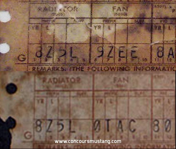

Might consider posting wanted ads around the internet so that you get maximum exposure
As far as the fan I guess you have already gone through the steps to determine which fan your car came with - Drag Pak verses non Drag Pak
For others who will see and read this thread both fans were used - just need to know what application is correct for your specific car
Do have other copies of 70 CJ buildsheets and some are coded "OTAC" instead as shown
The C9 was also used the same year

Jeff, I'm hearing the D0TA-C was recalled and the C9ZE-E was still used.  Could it be mine came with the D0TA-C fan (since the build sheet shows that) but it was recalled and replaced with the C9ZE-E?  My car was built on Sept. 29, 1969.  Would it be a Cardinal sin to believe that's what happened and use the C9ZE-E fan?  I found a 35 stamped near the end of the fan blade.  I assume that's for the 35th week of 69?  That would put it at Aug. 25, 1969  to  Aug. 31, 1969.
