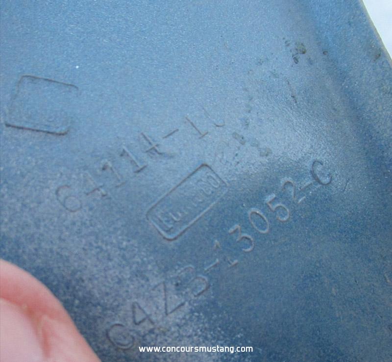

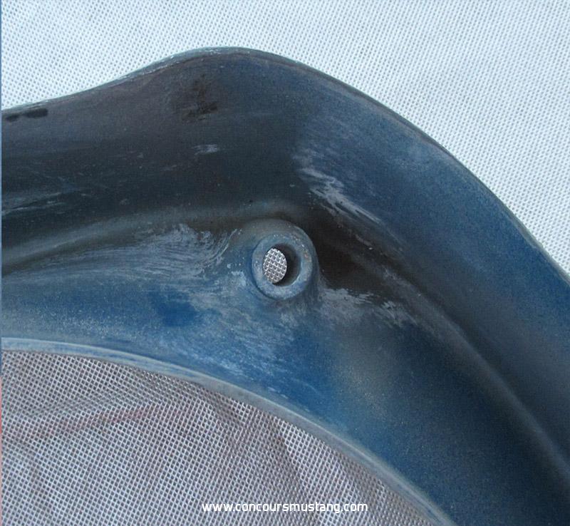

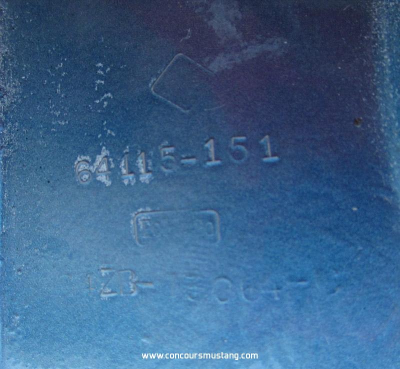

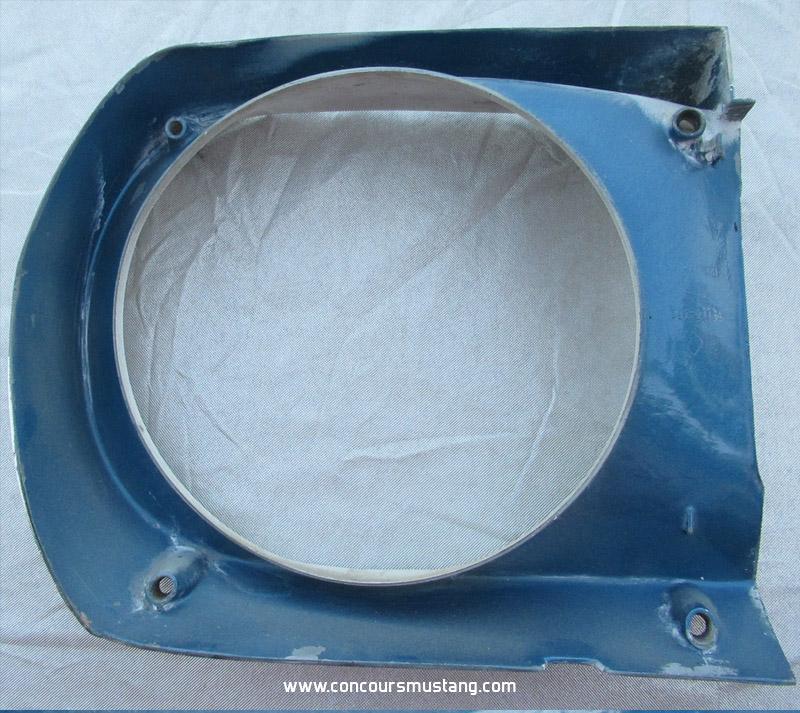

  • Posts: 24864
Re: 1965 - 1966 Headlight Extensions / Housings
« Reply #4 on: October 15, 2021, 06:21:06 PM »
Sorry this took a few days to get to and to remove them for the pictures. Here you go
Car is a San Jose car likely built the first part of Feb 1966
Still off for a few days if you need pictures of some other details
Offline sgl66
  • Posts: 462
« Reply #5 on: October 16, 2021, 12:41:11 PM »
That's the style of the one that didn't fit for me. Curious to know what the part # on the housing behind it is.
If it's the C5ZB-13A045-B that I'm about to put on, I'll spend some more time trying to figure out the differences
Offline rockhouse66
  • Posts: 958
« Reply #6 on: October 16, 2021, 05:39:58 PM »
Charles
This is the original RH headlight extension from my '66 San Jose car built late September, 1965.  If you need details from other portions of the part, just let me know.
