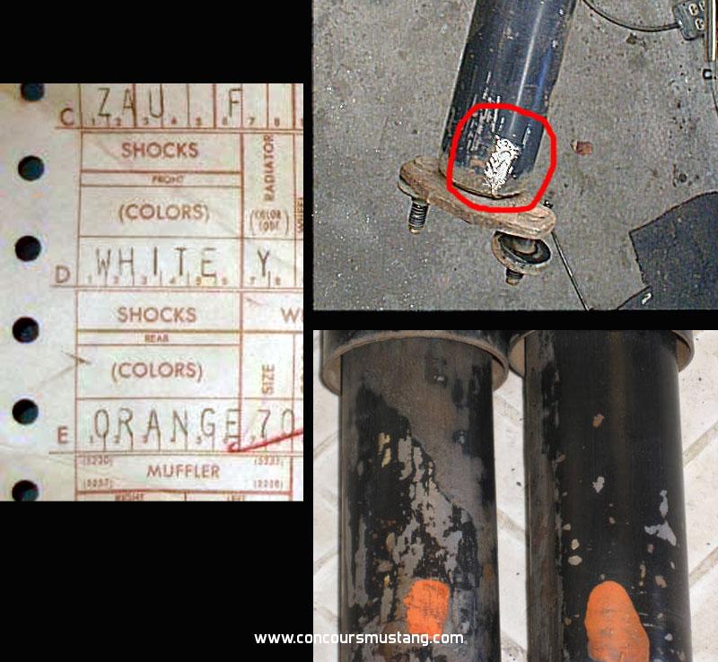

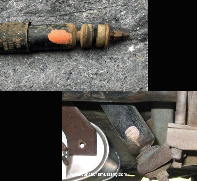

I'm redoing the rear end in a 70 Cougar 428/4 speed Eliminator built on September 29, 1969 in Dearborn.  I searched this site but I can't find any info that will help me understand what the codes for paint marks are.  I'm interested in the Rear Sway Bar paint mark.  The build sheet shows a X.  I see rear shocks should have a pink paint mark.  Would that be 1 or 2 stripes?  I believe according to the sheet the rear leaf springs should have 2 Violet and 2 Yellow marks on each spring.  I'd also like some assistance on the driveshaft markings.   Is there a list somewhere that translates these codes?
Re: 70 Eliminator Build Sheet question
« Reply #1 on: October 13, 2021, 09:47:32 AM »
Shocks were marked with a paint daub. It sort of looks like a old rag was used, dipped in paint. Marks are not consistent in size or shape because they are so crudely applied.
Same goes for the stripes on the drive shaft. It appears the drive shaft was being rotated by hand in a drive shaft lathe while the worker applied the paint stripe using a 1/2" brush. Very sloppy, sometimes dry brushed and sometimes drippy.

As far as shock markings you start to see the introduction of markings applied with a spray can or gun as well as the earlier method of using a 1/2 wide paint brush to apply a small or fairly small ;) daub at the bottom of the bottom section as shown in some other threads as well in the Library in the Article about basic paint markings

Looking at other 70 Q code 4 speed Cougars (non SCJ) I found the color coding for that specific driveline as follows - LBOGWH
First I didn't find any real late buildsheets to compare to you cars build date all are from earlier in the year. For earlier production 4 speeds with CJ or SCJ I found buildsheets and their color coding for the drivelines are different from the your cars buildsheet shows - LXMGWH
Believe the "X" and the "M" are misprints just like the other one mentioned below. Just someone really sloppy that day entering the information.
There is a mistake in the color coding of the front shocks on your buildsheet which shows "WHITS" which I believe is a misprint after comparing approx one hundred 1970 buildsheets with white marked front shocks called out
Hopes this solves the mystery and helps
