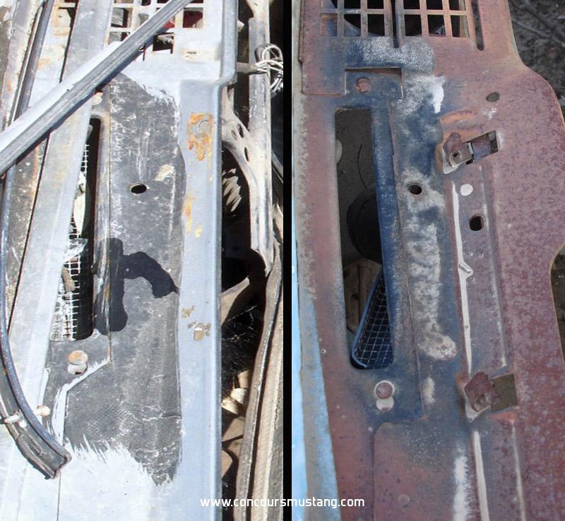

Detail 67gta289 was referring to on the dash top - defroster openings
67 Dearborn found applied with brush or spray
67 San Jose found sprayed
