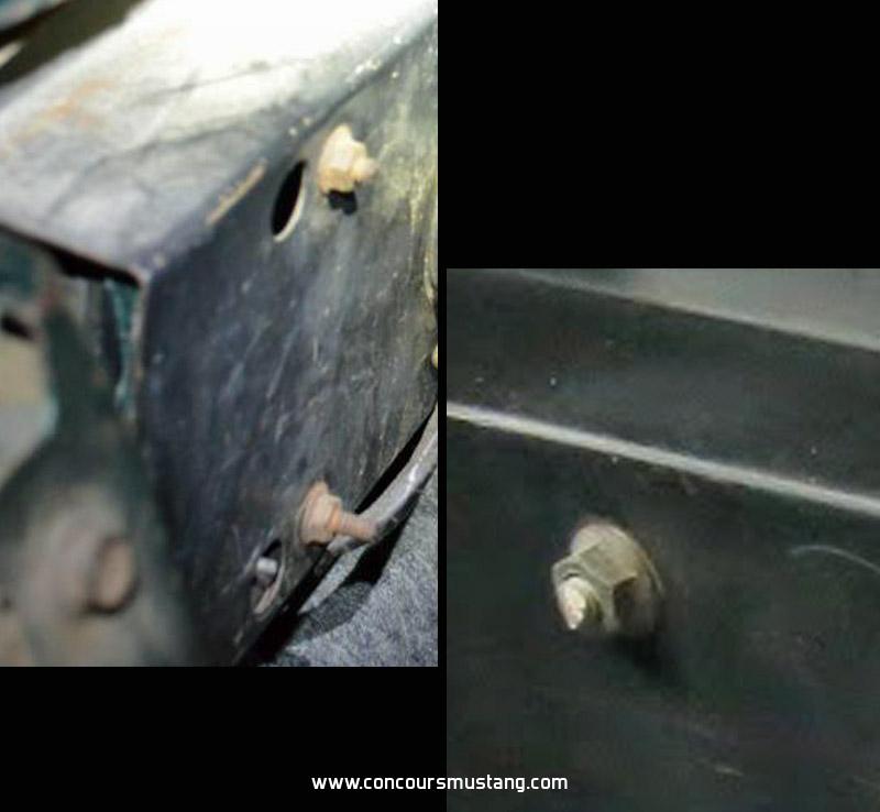

Pictures of the studs and nuts

« Reply #5 on: December 01, 2021, 09:22:38 PM »
I have the assembly manuals, but the Shelby housings are different. The upper left of the left hand picture here doesn't quite show the flange nuts 6 upper, 6 lower per housing left and right. Those are spinning. I can see the stud rotate with the nut when I turn it. No real room to grasp the top of the stud and spin the nut. I can try it. I didn't really try and turn the 6 or so studs on the back of the black housing. I thought those were to hold the light fixtures to the black housing. I could be wrong since these housings are new to me.

« Reply #6 on: December 01, 2021, 09:26:47 PM »
It looks like in the pictures that I should concentrate on the 6 studs on the back of the black housing? Once the tail light lenses are pulled off from the back, the flange nuts and studs of the housing to fiberglass panel will be more accessible?

« Reply #7 on: December 01, 2021, 09:56:35 PM »
The flange nuts hold the studs and 67 housing to the black Shelby tail light box which is secured to the sheet metal of the regular Mustang tail panel rivets. Yes you need to take the flange nuts off of the 6 studs on each side. The nuts are taken out from the trunk side.
