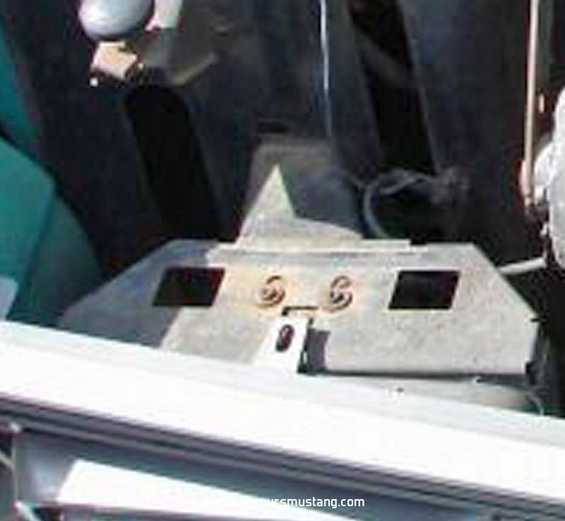

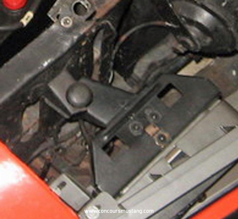

 My sport lamp doors on the grill were replaced many years ago.  A few years after replacement the sport lamp door top mounting tabs cracked (I also believe this is why I replaced them many years ago).  Attached is  a photo from this concours forum of a Dearborn red Mach1.  Looking at the red mach I the top tab is bent down from the retaining screw. My top tabs were bent like the red Mach 1.  I beleive my top tabs cracked due to bending stress. I want to verify that my SL doors are mounted correctly with the correct hardware.  I investigated the 1970 electrical assmbly manual drawing and the hardware spreadsheeet available on this forum.  My SL doors appear to be mounted correctly but I am not sure if the spring nuts are correct.
I am interested in knowing the physical details of the Nut Clip and photo of the fastener used on the two bottom tabs of the sport light grills.  As per the electrical assembly manual the P/N should be 45257-S2.
- Both documents list 383347-S2 Nut - Spring Clips (6 required) (.870Lx.530W) assembled on the two metal brackets.  I verified my brackets have the correct 383347-S2 spring nuts.
- Both documents list 45257-S2 Nut - Spring Clips (4 required) (.800Lx.530W) assembled on the two sport lamp door bottom mounting tabs.  Looking at AMK F1071 kit for sport lamp door mounting, (https://www.amkproducts.com/search-result/?ser=F-1071) it appears that the AMK BFC2 (6 pieces) nut clips are the four required 45257-S2.  Is this correct?  Any help is appreciated.  Alan

Jeff, I really appreciate your effort. Thanks. Looking closer at the electrical assembly manual, I determined the upper 383347-S2 Nut Clip on the bracket was assembled backwards.  I found the bracket height can be  height adjusted.  After trial an error fitment / of the sport lamp doors and height adjustment, I think my brackets were too high.  I will verify there is no bending stress on the upper SL door tab after the hardware confirmed.  Alan

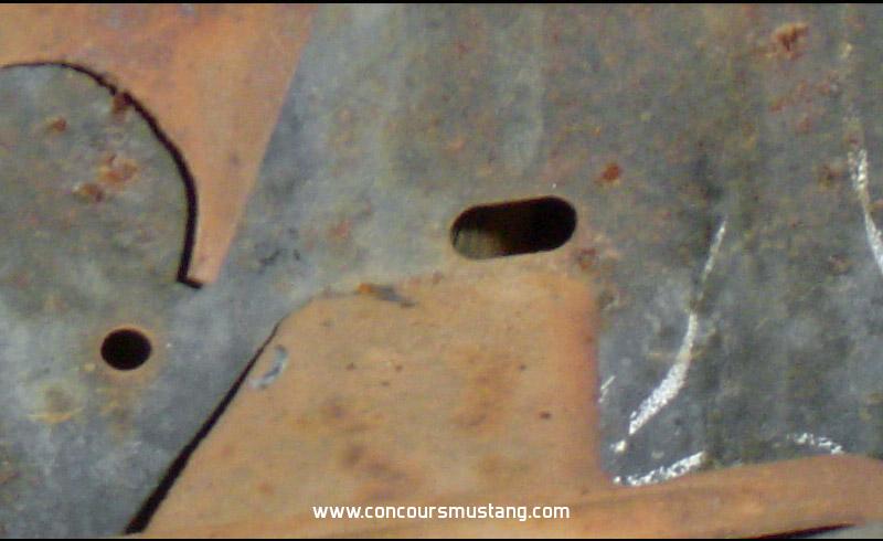

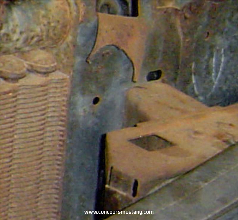

Good to hear that you figured it out. Seems that the area is not one that is popular with people when they take pictures of their cars :( But not a big surprise.
A few pictures of that area though none may help at this point.
