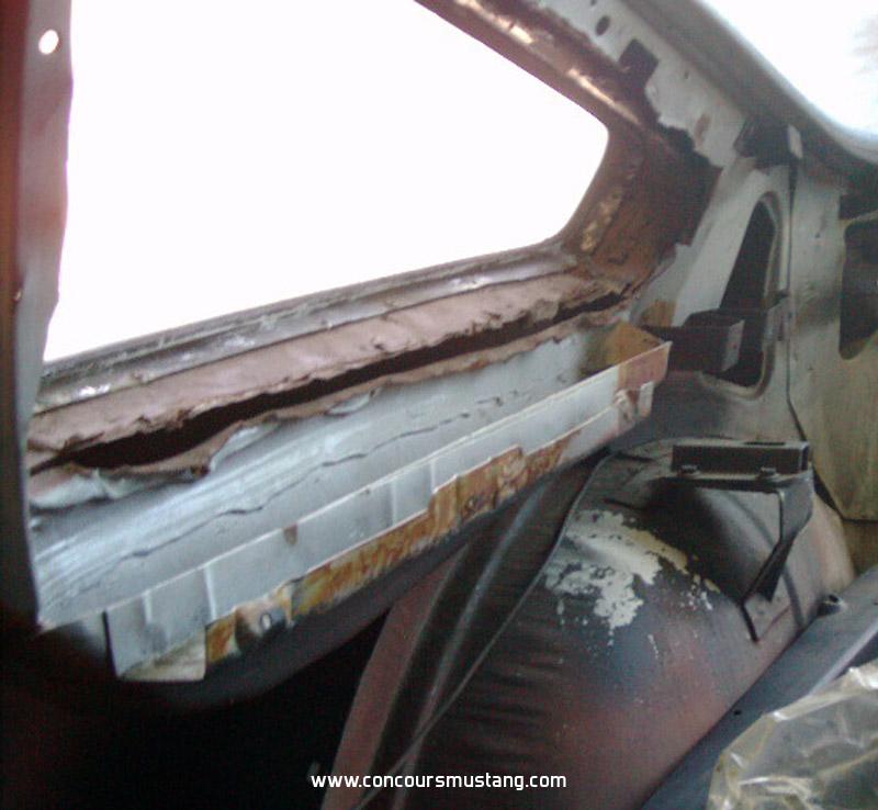

First contribution for me on the subject - Included above
6R163xxx

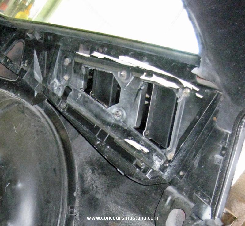

Happens to be a likely an early Feb or late Jan 66 built car. Though its a Shelby the picture shows the water shield and spray adhesive on the B pillar that was likely used to secure it originally or at least they tried
Also does it look like they also used spray adhesive along the rain gutter to hold the shield in place - hung it?  We've heard others describe and I've seen it where San Jose used a gray putty/dum-dum like product along that upper edge. Maybe they used both during different production periods
They did use a black dum-dum to seal around the vent assembly above the rain gutter. Believe it was only on three sides. Top and ends
6R164xxx

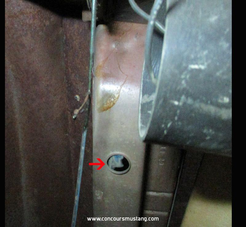

Next one  6R1578xx
Not much left to go on except the lack of the nipple for the hose

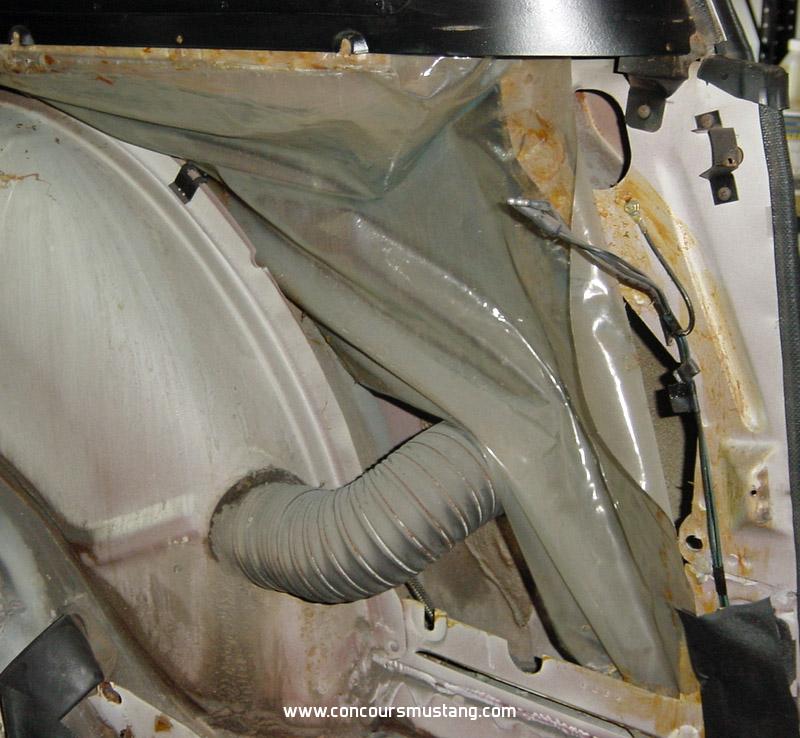

Two more examples
6R130xxx No clear view of the rain gutter design. No hose present. There is spray adhesive along the edge of the rain gutter

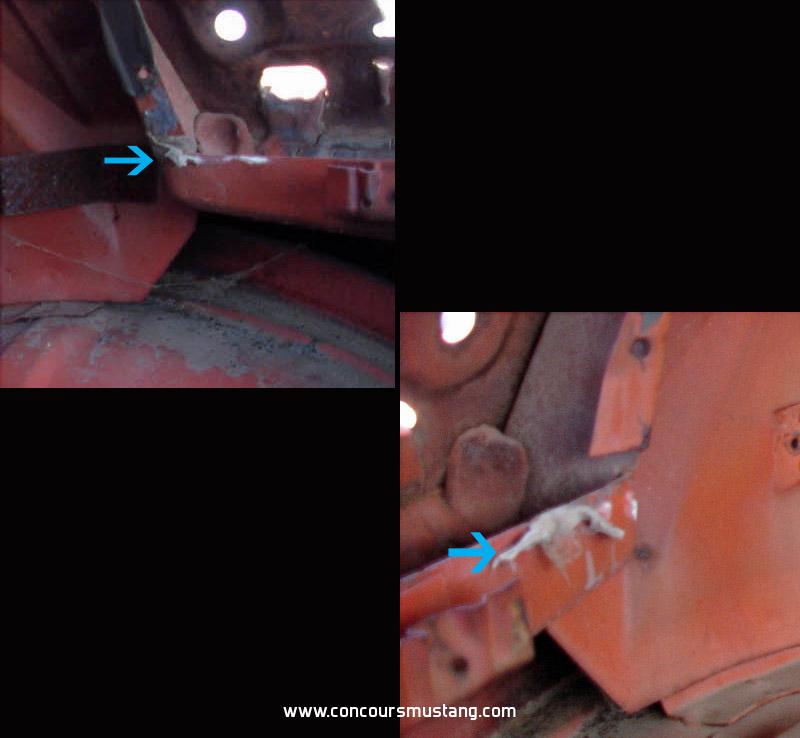

And a very late example. Again no clear picture of the train gutter and no water shield attached when the picture was taken but there does appears to be some of the light gray stuff that some of us have seen used to attached the water shield to the lip of the rain gutter
6R22xxxx
