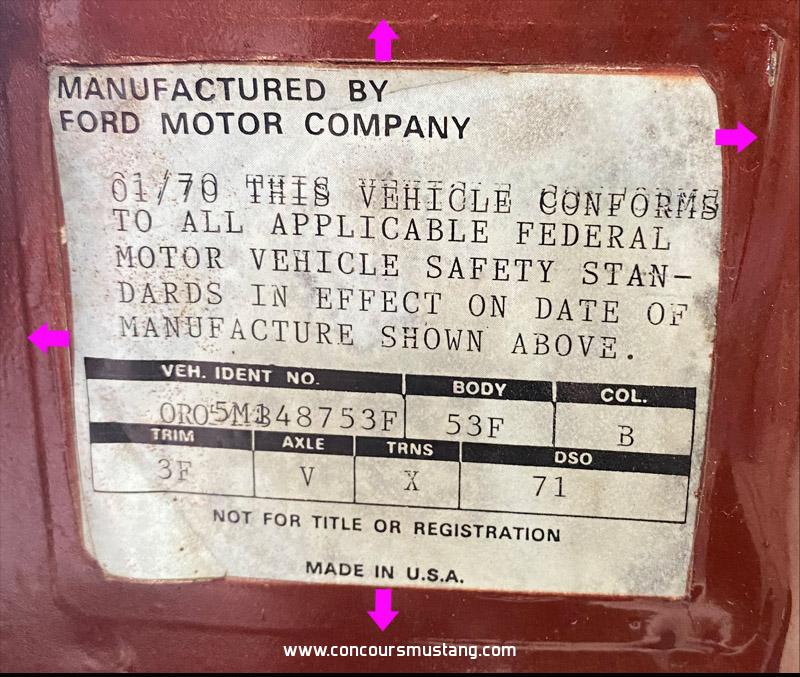

Hello, I have questions about my door tag decoding analysis.  Is there some where to look for breaking it down to determine what the codes represent. Attached is a tag I am looking at decoding. Thanks for any leads.

You should really order a Marti report for this car. The door sticker pictured looks to be something that a previous owner made. Some of the codes on the tag are not correct for a 1970 Mach1 with a 351-4V engine and being that some of the codes are completely incorrect I would suspect that the codes that could be decoded may not actually be original to this car. Better to get a Marti report to see what the true correct codes should be.

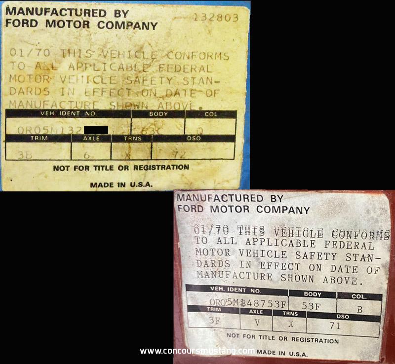

Before we even get to the decoding of the information in the lower boxes the first thing that stands out is the fonts used in both the upper text and filling out the information below that on your example does not match what I've typically seen and documented for San Jose during 1970 production. On your example it also lacks the coding in the upper right corner of that label
- Over stamp of the VIN is not common. VIN suggests a 70 Mach I with a 351 4V. Never seen a letter at the end of the VIN on one of these
- Body type "53" matches the code used to identify a Ford Custom 500 that year
- Color code "B" was not used in 70 for a Mustang application but was for other Ford models
- "3F" for the interior was not used for a Mustang that year
- "V" would normally be for a 3.91 traction lock rear end
- "X" would have been the code for a FMX transmission
- "71" was the coding for a car ordered from the Southern Calif district
Could be an older reproduction.
Here is another example from the same time period and plant to compare to
Also notice that on the one you posted the size of the label is much larger than the original example I posted
Well obviously a bogus tag, but 3F was definitely used in 1970 and indicated a Ginger mach 1 interior. Also paint code B was used on 70 Shelby Mustangs. V code axles in M codes are uncommon but I have one and I have Marti reports for a couple of others although they are all 4 speeds. There were 70 mach 1s painted the same paint code as the B maroon, but they were special paint instead of B.

Yep missed the "3F" right at the top of the section in the reference I was using
We may never find out if any of the coding is original to the specific car

Does the VIN on the repo tag match the dash and inner fender numbers? Also, a consecutive unit number of 148753 would more likely correspond to an April build date, not January. *EDIT* it does look like the tag indicates 04/70; don't know why I thought it was a 1.
