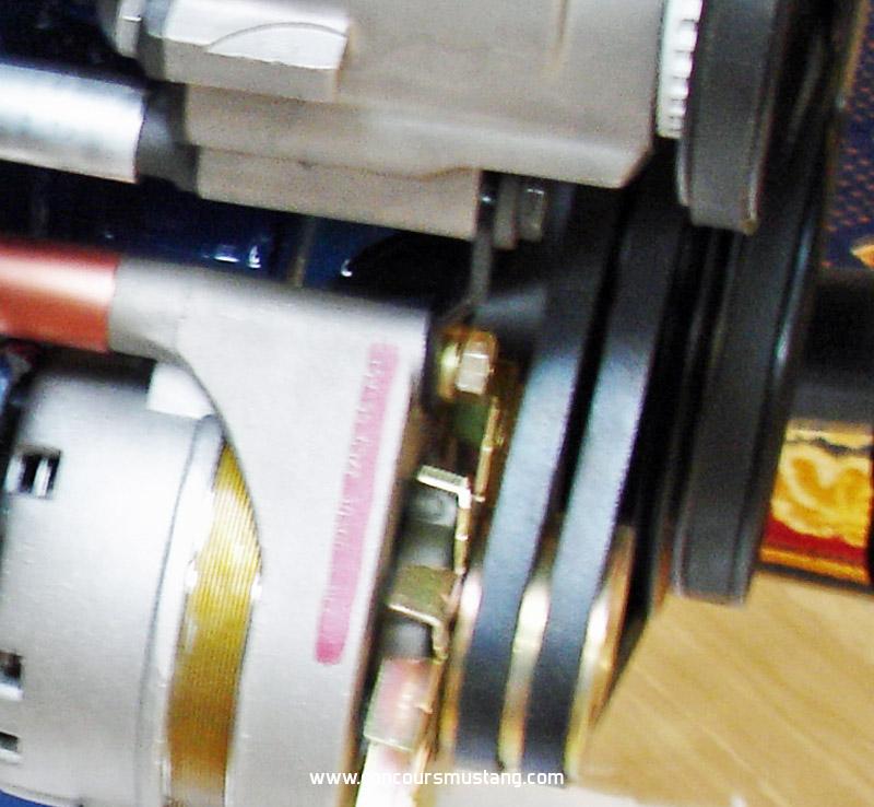

Im assuming
#1  the lower alt bracket goes behind  the alt mounting plate to address the gap
#2 is for the smog pump bracket (waiting on)
The reason I asked about the spacer is due to the gaps as shown.
If assumptions are nearly correct then it is the correct alt spacer in pink.

That helps.   Lower alternator bracket sits ontop.  Thanks
