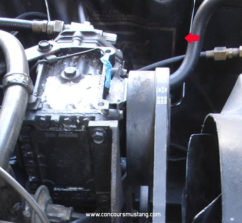

Disregard Jeff's arrow for the washer bag, the part we are speaking of is bolted to the top of the AC Compressor.
« Last Edit: February 07, 2022, 07:58:40 PM by 67gtasanjose »
Re: Clamp to attach thermactor air hose to air conditioning compressor
« Reply #6 on: February 07, 2022, 08:18:37 PM »
This one? If so, it's part of the "Holder Assy, C7AA-2979-A". It may be documented in Ford Car Parts.
« Reply #7 on: February 07, 2022, 08:53:41 PM »
Not the wire clamp. The one with the yellow arrow that secures the smog hose to the compressor.
« Reply #8 on: February 08, 2022, 12:03:31 AM »
That clamp's Ford part number is 376906-S (no finish or special treatment referenced on the assembly drawing) shown on the "1967 Mustang Engine Assembly Manual" (AM0157) pg 117, item 41 (it's also used in 1966). It is shown with dimensions in the "Ford Standard and Utility Parts Catalog, January 1969" (AM205) pg 42 where it has a "-S100" suffix, indicating the finish is on the drawing and would include the rubber coating.
Comparing the drawing and the picture, there may be a difference in the rubber coating. The drawing indicates a "dipped" rubber coat, the picture may show a formed rubber partially wrap around the clamp with the open portion exposed.

Jim, if referring to MY picture(s) within this thread, this is the result of a "sloppy dip" (on a reproduced part). I no longer have the original part. I can search to see if I took pictures of it but it (like Jeff's picture) was in somewhat deteriorated condition.
