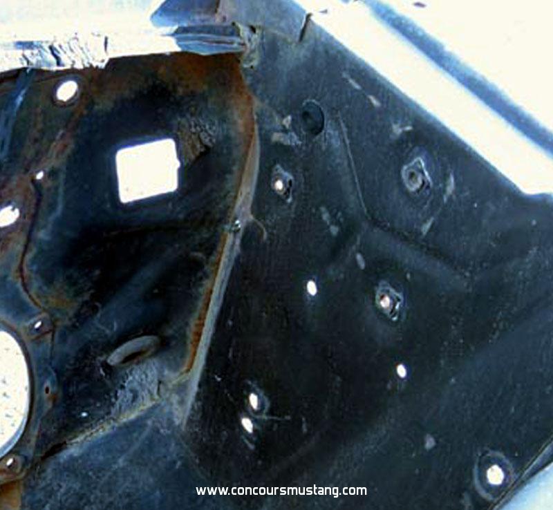

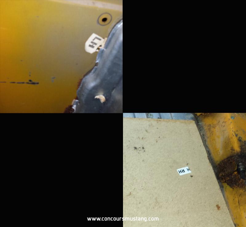

So working through the pictures/areas shown above
Picture #1 No sealer used on or below the transition panel between the rear inner to cowl
In the pictures the sealer would have been applied over the firewall to cowl pinch weld in front of and behind the cowl panel edge at the forward edge of that panel that sticks upward. Green arrows in the first picture. During that application the worker could have continued to apply the sealer once he reached the end and applied it over that small panel though this is not often seen. Bottom picture shows an example of that

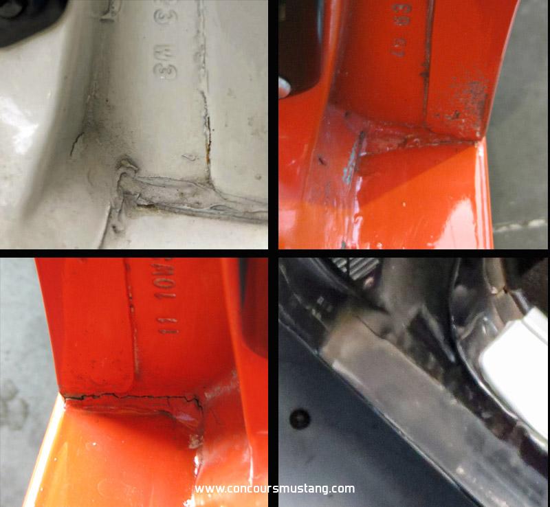

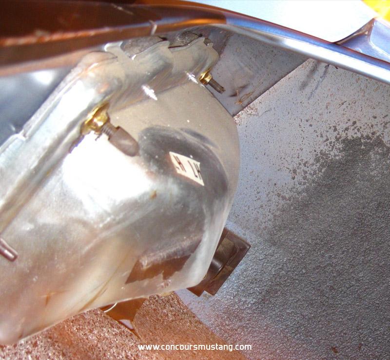

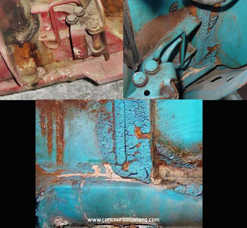

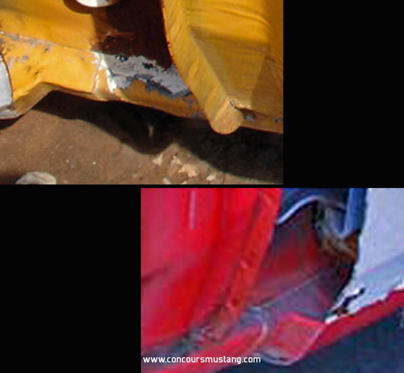

Picture #2
The rear inner fender panel on the drivers side to the firewall. No seam sealer was typically applied between these two panels. Later spray adhesive/sealer would have been applied over some of the firewall surfaces shown in the picture but not before painting
Picture #3
The rear inner fender panel on the passenger side to the firewall. No seam sealer was typically applied between these two panels. Later spray adhesive/sealer would have been applied over some of the firewall surfaces shown in the picture but not before painting

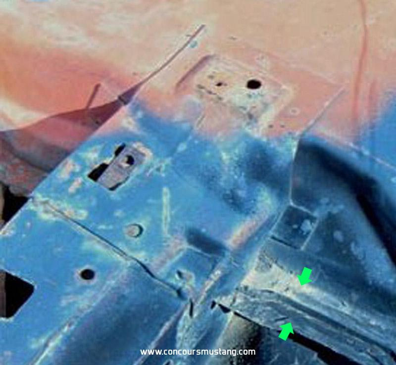

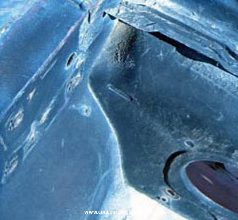

Picture #4
A pillar base to rocker panel. The sealant we see in your picture would not have likely been there originally and products used anywhere near there would not have the top texture for lack of a better term

« Reply #6 on: January 25, 2022, 06:17:29 PM »
Perfect. Its going to paint tomorrow so some of the sealerwork needs to be done again ?.!
Thanks so far.

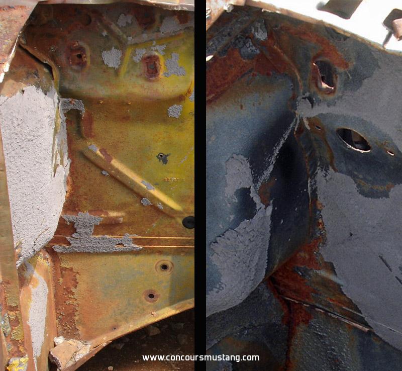

Picture #5
B Pillar at rocker. Often non visible along the section that is visible spot welded of the panel along the top weld of the rocker panel in the door opening. Just like the quarter panel to B pillar. You want to see those spot welds not hjdden below high fill primers and such
Along the corner seam between the rocker, quarter panel lip and the B pillar panel we typically find a very small strip of caulking applied as shown in the pictures below

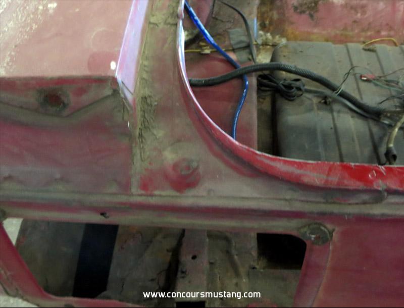

Pictures #6 & #7
Rear quarter panel filler panel and trunk opening corner
Not much if any sealant in this area. Typically the edges of the corner trunk opening to taillight and quarter panels are fairly sharp and not hidden with a coat of sealants. Around the quarter panel filler panel there was typically an application (wiped with a brush or solvent rag) around the edge of the quarter panel as shown in the picture below
Wished I had cleaned this off before I took a picture. Lots of body shop dust  ::) Barely make out the wiped sealant but does show the corner trunk opening panel edge well
