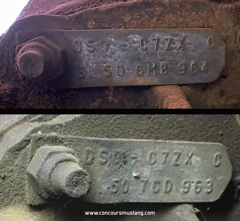

Re: Paper axle tag code
« Reply #18 on: February 06, 2022, 03:01:57 PM »
The rear end metal tag you posted would have a paper axle tag like the 964 A example in Reply #2 .
+1
Interestingly there were two different codes used for the same rearend ratio in 67 for Shelby's so you have narrowed down which one yours had by locating the tag
Earlier version above and later below
One of the following questions will be to figure out what color of paper to have them printed on.
