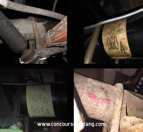

The number of numbers used on the paper axle tags depended on the year the car was constructed. Either 3 or 4 numbers depending on which classic period Mustang and in turn Shelby.
Where did you find that number? (8935A) As the number suggests a 68 application. The 935 would suggest a 3.50/1 gear ratio.
67 Examples for discussion and comparison. Commonly found with 3 numbers
