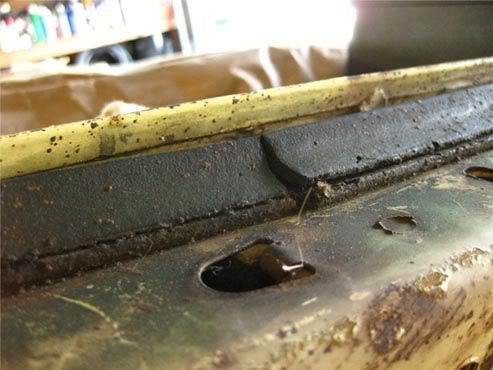

« Reply #4 on: March 07, 2011, 10:11:15 PM »
Yes that is a service replacement (have a few also :( profile - its shaped differently than the original simple "U" shape - well sort of but very different than the "NOS" one
An original example with the "open" end installed towards the inside of the trunk lid
