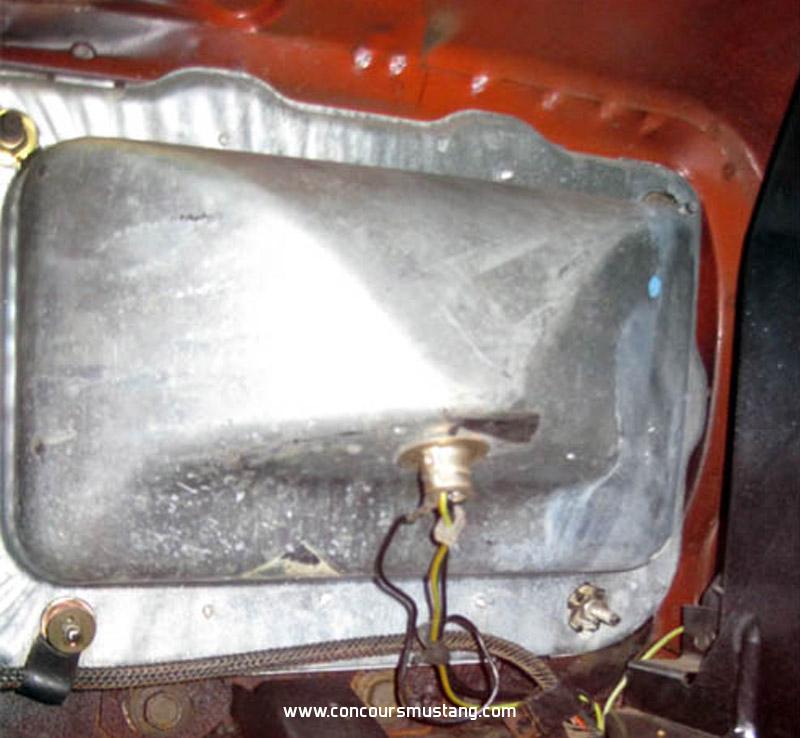

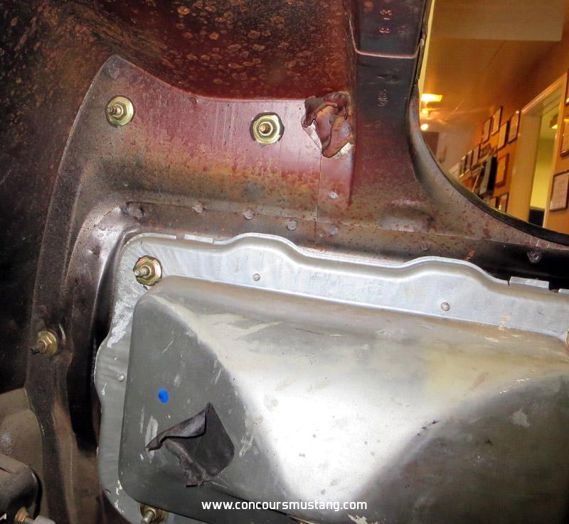

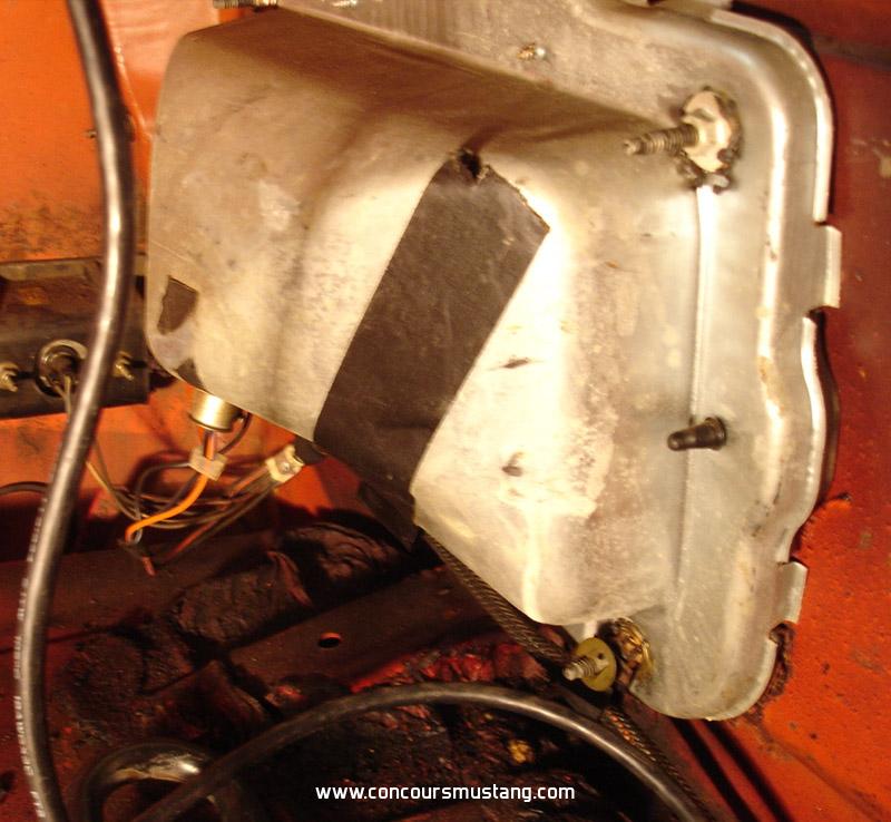

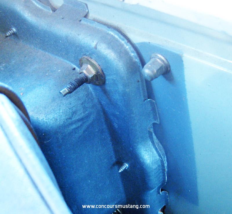

Don't have any clear pictures of NJ taillight buckets. NJ cars can be difficult to find in even nice unrestored condition
Since these were likely painted and supplied by the same provider as Dearborn you may be able to apply what you see here. Of course there are always examples where the worker may have messed up or not have been as careful as they should (like the drips and smudges mentioned above) so since your car sounds like you don't have any evidence on your car to document IMHO you should go with what was typical rather than follows the oddities
Here are a few unrestored examples from Dearborn 70's. For others ignore the paint details in the following pictures as there are many different models the samples were taken from so they might not match how your specific car was built

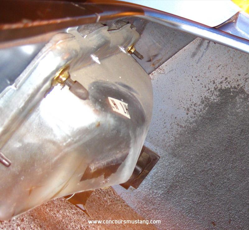

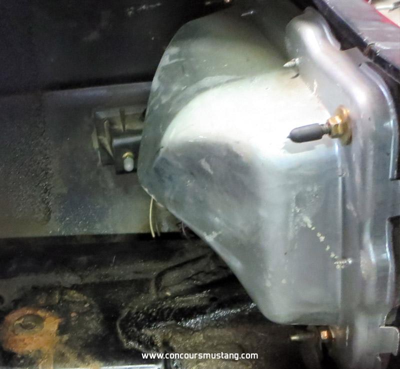

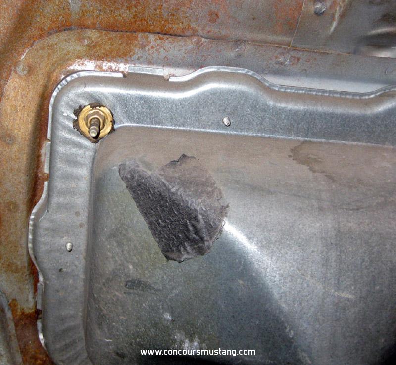

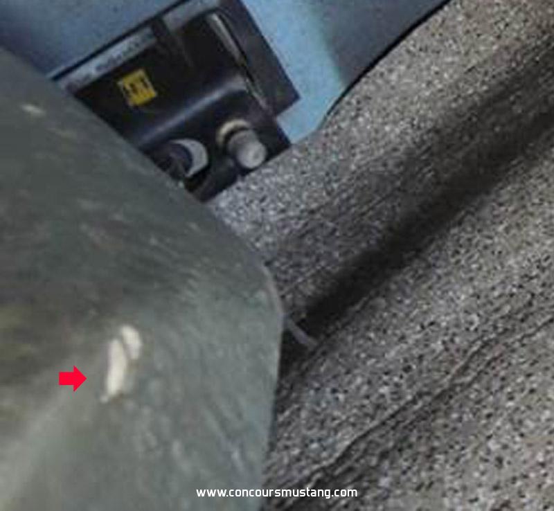

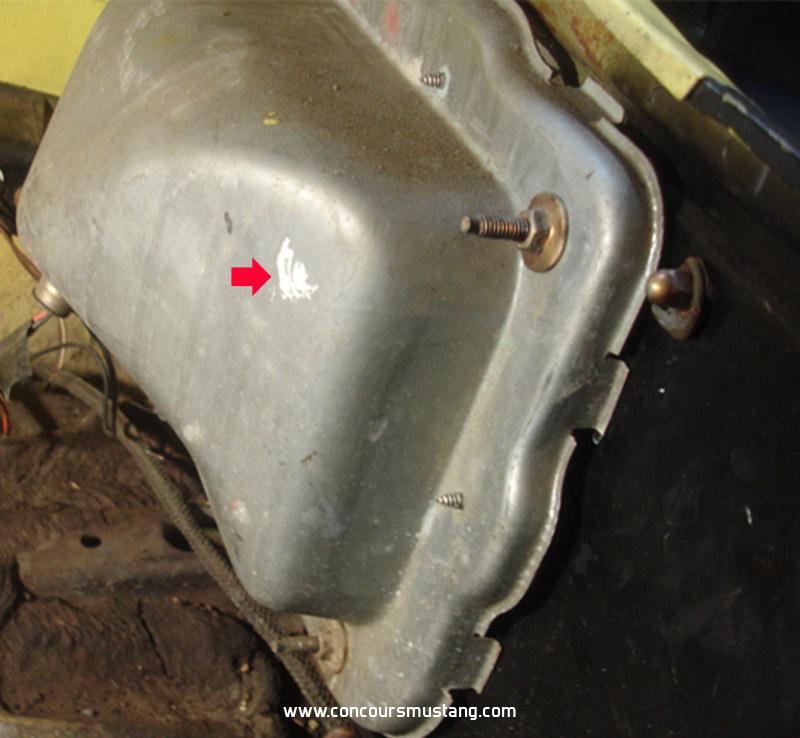

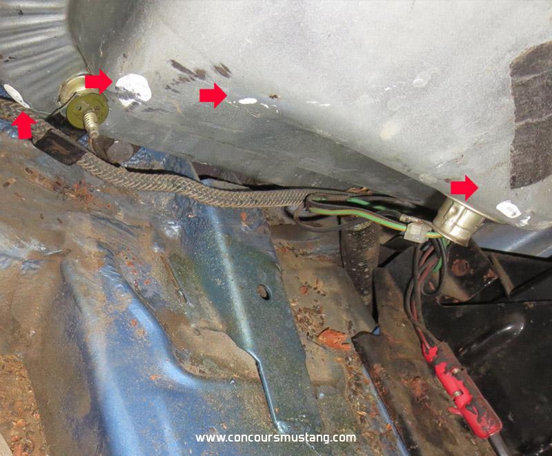

As for the smudges, drips and drabs mentioned above here are some pictures of what I was trying to describe. Appears to not have happened very often but wanted to share. None of these are white cars or with white exterior repaints

Excellent. Thanks Jeff - exactly what I was looking for.

My take on the white smudges and drips is this might be a by product of how these were painted and then hung to dry.
Just a thought.

That would match what I'm seeing and showed above
