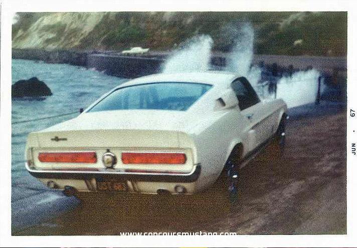

Car is 1967 GT500 Built 1/26/67 #817. ...........
For comparison I have unrestored examples built at San Jose 1/25, 1/27, 1/31 & 2/2 with the early version of the rear valance. Believe a couple of days after 2/2 they started to install the GT version based on the unrestored examples I've collected
2/2/67 example
