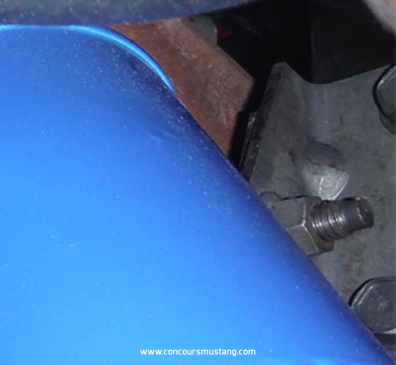

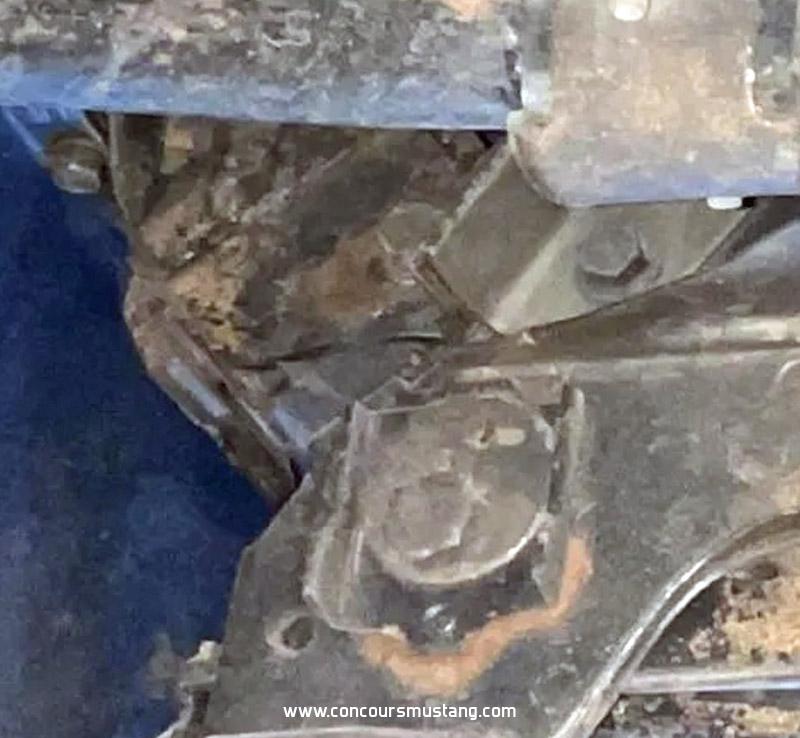

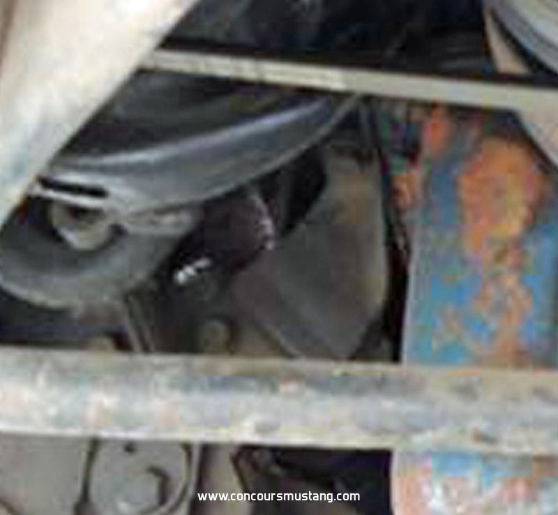

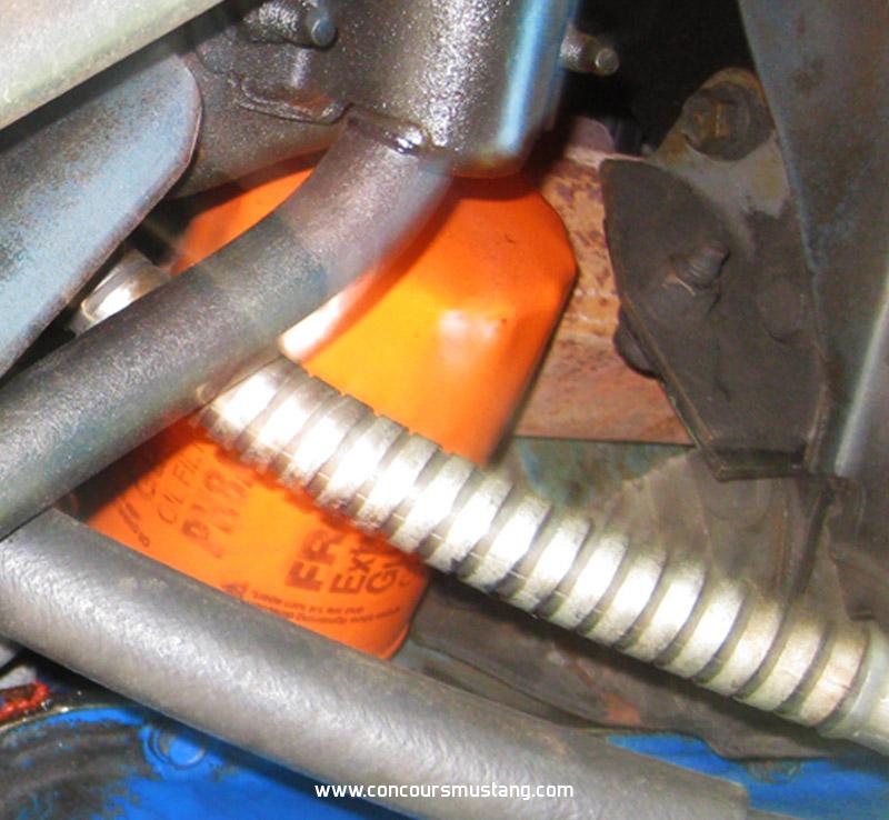

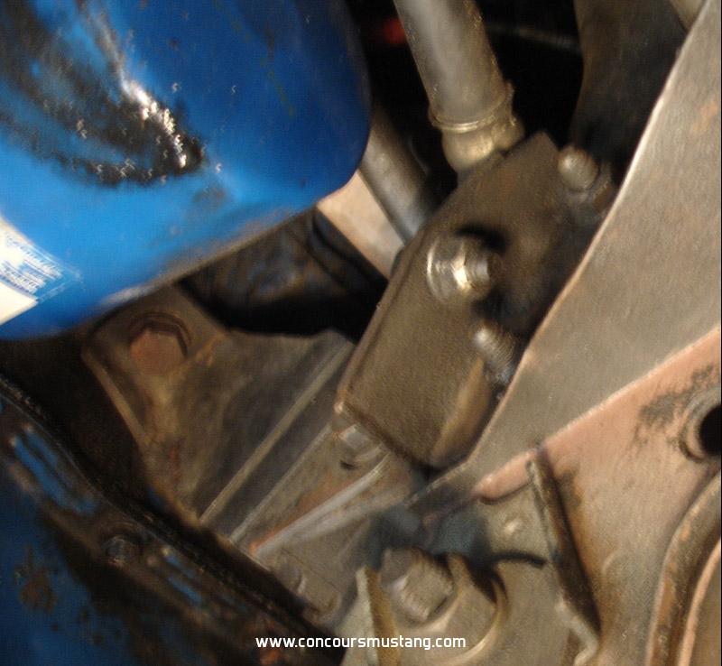

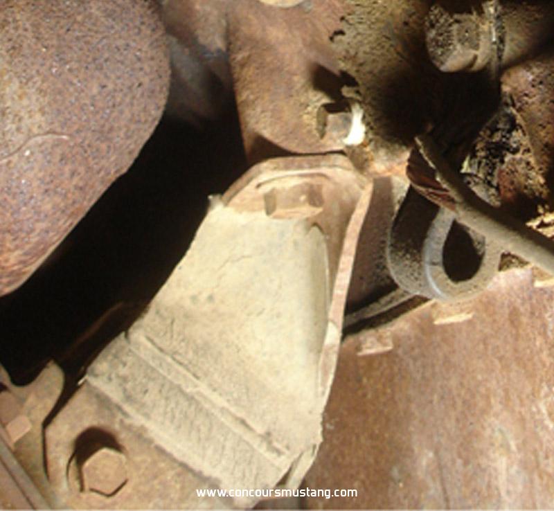

Not an easy place to get a picture of. Hope the following helps both you and other owners of these cars - the reason I'm including examples from other production periods.
0F02G1000xx
0F02G131xxx
0F02G142xxx
0F02G157xxx
0F02G169xxx
0F02G199xxx
0F02G206xxx

Is it safe to say the first 3 photos 0F02G1000xx, 0F02G131xxx & 0F02G142xxx would all be early 70 production (sept-Dec 69)? They all appear to show flanged headed bolts and nuts, so I think I have got my answer!
1970 BOSS 302
Built 11/15/69 Dearborn
Re: 1970 BOSS 302 motor mount bolt arrangement
« Reply #3 on: February 24, 2022, 07:08:01 PM »
Is it safe to say the first 3 photos 0F02G1000xx, 0F02G131xxx & 0F02G142xxx would all be early 70 production (sept-Dec 69)? .............
0F02G1000xx- Built 8/2/69
0F02G131xxx- Built 11/21/69
0F02G142xxx- Some time in Dec 69
